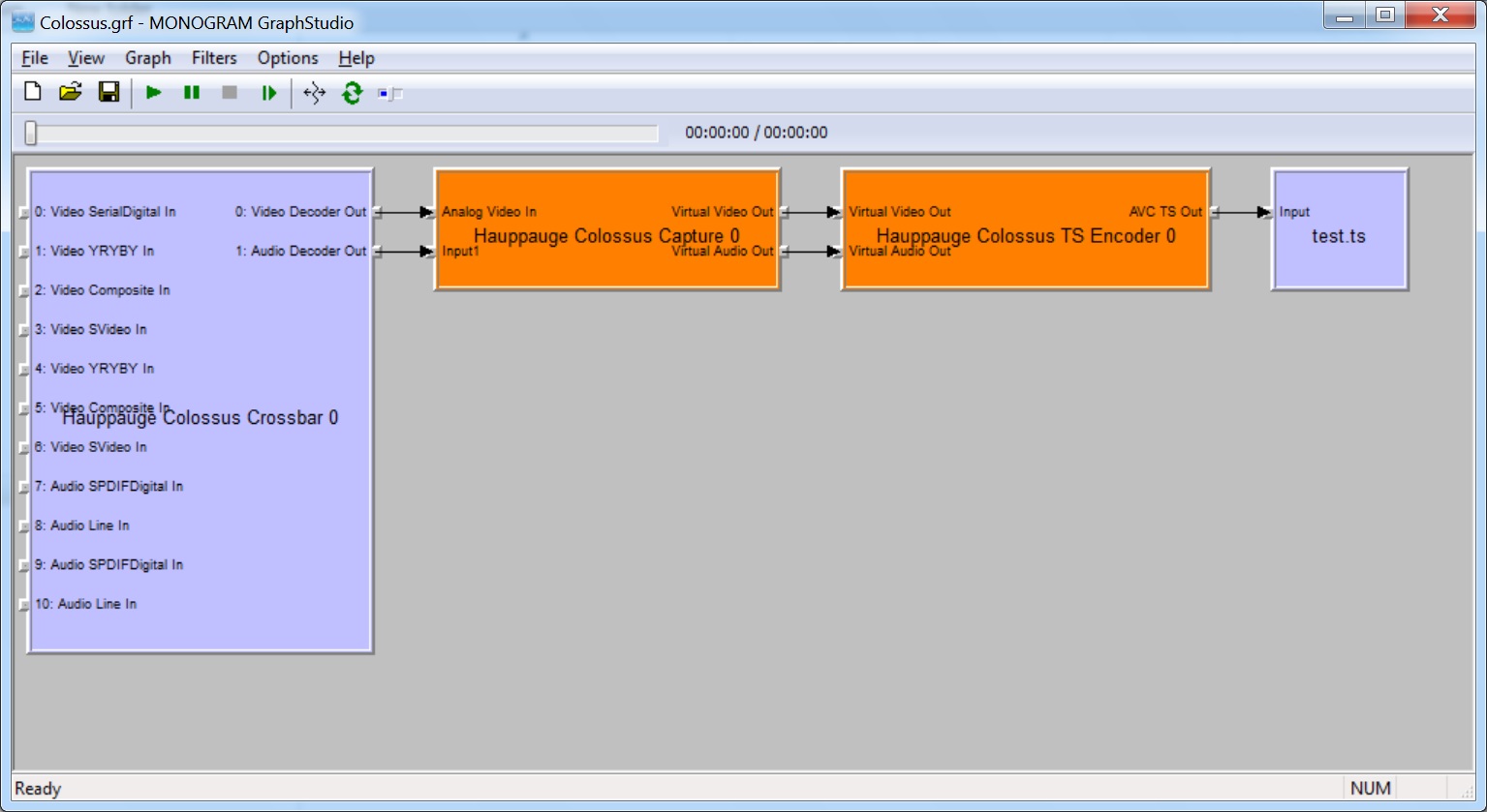

  8. Originally Posted by MounaLafi View Post
    So, which program I should use.
    I used to use a filter graph and rcTvCap along with Windows' Task Scheduler:
    http://blog.arogan.com/2008/06/hauppauge-hd-pvr-model-1212.html
  9. Banned
    Freedonia
    Very interesting, jagabo. I had not heard of any of that before.
    Dec 2008
    Switzerland
    I've already give a try jagabo.
    The issue is that I can't find a similar Video Encoder for Hauppauge Colossus like Hauppauge HD PVR.
    As you can see in the attached jpg the only Video Encoder I've found for Hauppauge Colossus is TS Encoder,
    and the problem that it doesn't have "Virtual Video/Audio In".
    I'm just wondering if anyone used rcTvCap successfully with Hauppauge Colossus or is it just limited to Hauppauge HD PVR?

  11. Banned
    Freedonia
    I had no idea that what jagabo is doing was even possible, but I personally find the graphing system cumbersome to use. I haven't done that in a very long time. Of course, others may not feel that it is cumbersome to use at all.
    The Colossus and the HD PVR family of devices use exactly the same encoding chip so if it works on one, it should work on the others.
  12. Originally Posted by jman98 View Post
    You only have to do it once. Then you save the graph.
