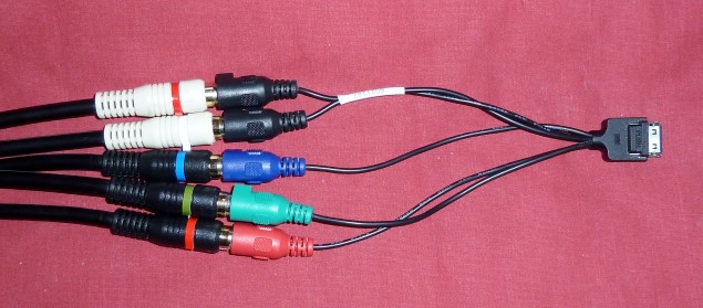

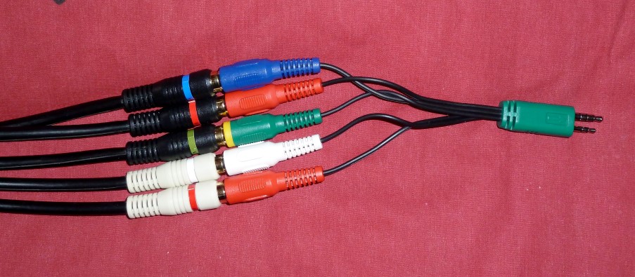

    Hi thanks for replies -
    This is the TV I got http://www.panasonic.co.uk/html/en_GB/Products/VIERA+Flat+Screen+TV/Smart+VIERA+LED+TV...trackInfo=true
    It seems to suggest a shared input for Component and Composite video - so am I right in thinking that if I feed it component it should still display it? That said I cannot see any picture so can't judge if it is component or composite.
    Due to it's thin profile they give you an adaptor like so - (attach1)
    I plug this into the AV2 input and was hoping to get a picture. I notice that the remote control allows me to select Video or Component but doing both still don't present me with any picture.
    The other end I use the cable adaptor that came with colossus... (attach2) I'm always unsure weather this as seated correctly as it doesn't click or let's you know it's in the port, but I've pressed it as firmly as I can and it doesn't pop out or anything.
    So I'm a bit stumped. I suppose I could feed a separate HDMI cable from the Tivo box downstairs but I would need to buy a 3-way HDMI splitter and I only just bought the Neet 2-way Splitter a few months ago. Should have done some forward thinking I suppose.

  27. I think you have it wired up correctly. Try removing the Colossus from the loop. Run a cable (and adapters) directly from your source (cable box? satellite box?) to the HDTV. Be sure you get a picture. Then add the Colossus back into the loop. Have you successfully gotten a picture in the software for the Colossus?
    Thanks, I've got a picture now and it shows simultaneously both via the PC (Arcsoft) and to the TV. It's a very good picture to the TV so I'm happy with it. I can't get no sound though, tried optical out but no luck. Wish there was a way of connecting via HDMI as that carries the sound/video all-in-one. If i'm using a two-way splitter from the cable box downstairs to feed one of the HDMI leads to the Colossus in the upstairs bedroom, could I use another 2-way splitter upstairs to send a direct HDMI signal to the bedroom TV?
