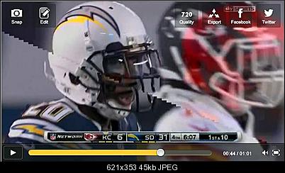

    Forgive me I'm currently working my way through this thread after a recommendation from BOMOON on the Hauppage UK Forum who appear to leave my posts on the pre-moderation shelf if it goes beyond a couple of sentences and becomes a paragraph or asks anything to challenging.
    I'm on the verge of sending my Colossus PCI card back for a refund, concluding that the card itself could be faulty.
    May I ask a question. Would my monitor (NEC 20WGX2) which does not support HDCP affect the video I capture using Colossus PCI card? My Graphics card Geforce9800GTX+ is connected to the monitor via DVI but states Playback of HDCP-protected content requires other HDCP-compatible components.
    At present I am running the HDMI cable from my STB downstairs to Colossus Card in PC upstairs. I have an HD Fury which converts to component and strips out HDCP content (I know naughty, naughty but why are the big cheeses getting in a tither and preventing us doing with HD material what we could with SD) I digress...The HD Fury I have tested directly to Sony Bravia HDTV downstairs and the picture is fine without any noticeable imperfections. I am using ArcSoft Showbiz to record the capture but my results are not entirely satisfactory. Here is a clip of one of my latest captures http://www.dailymotion.com/video/xusoc1_hd-fury2-to-colossus-pci-e-test-video-capture_sport
    ...as youcan see it's not perfect. Sound is okay but the picture is hard to watch especially during fast fluid action. It's very choppy and flickers. I've also grabbed a screencap and there's adiagonal jagged line that frequently appears in the video (more noticeable during scene transitions)...

    ...but could it be my monitor which is causing this problem? I can understand why it may show the problems I'm encountering on live playback, but to affect the actual capture which is done by the card itself?

  6. I don't think there's any way your HDCP-less monitor could be the cause of the jerky video.

    I see "Quality 720" in the info icon display. Was that really an HD capture? The aspect ratio looks like 16:9, or 1.77777.....
    If "quality 720" really refers to the resolution, and the aspect ration is really 16:9, that would suggest that you captured at 1280 X 720 (p or i?).

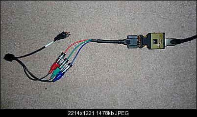

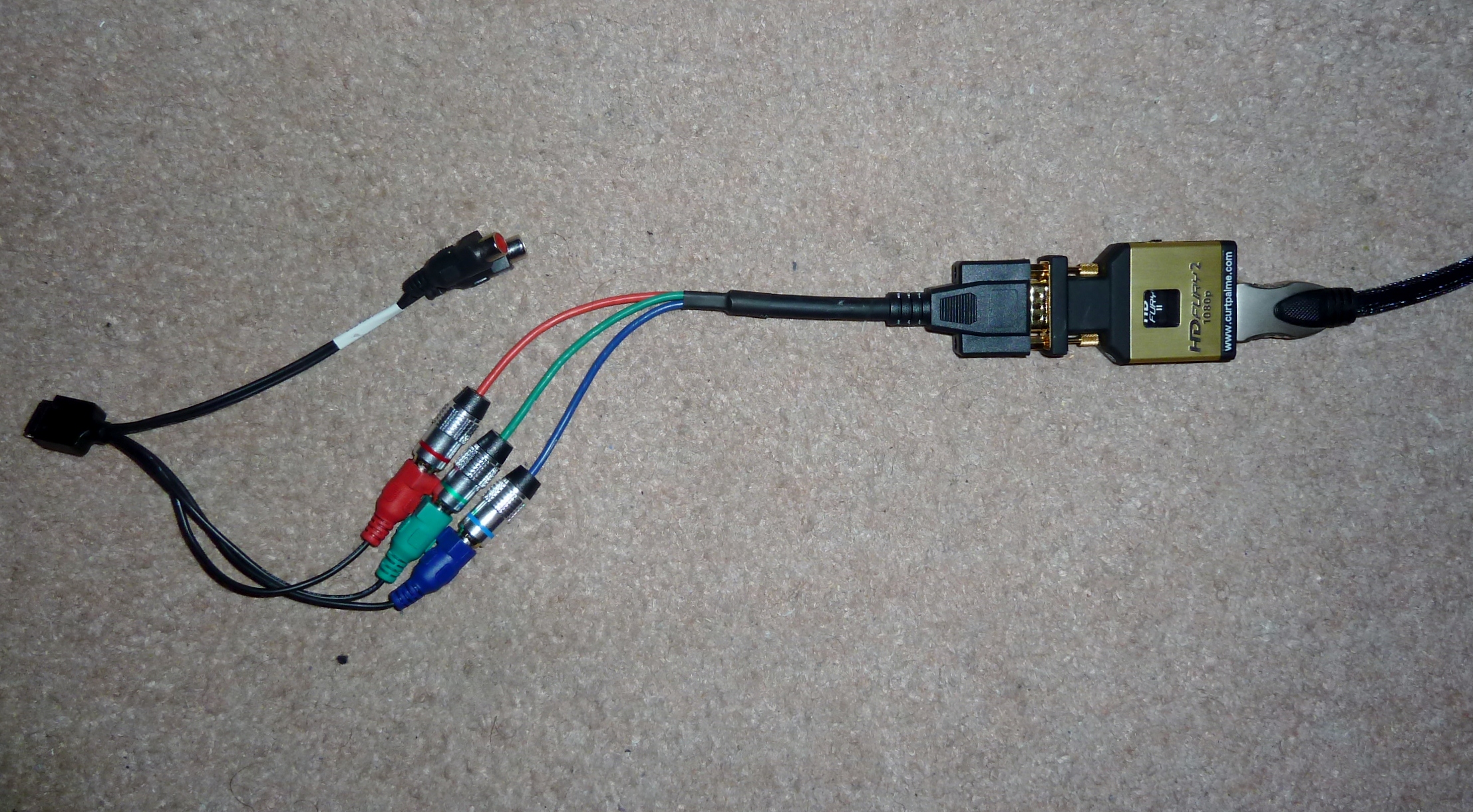

    Tom & BOMOON - I am not able to capture directly using component as VM Tivo box only fits the HDMI out http://cdn.electricpig.com.s3-external-3.amazonaws.com/wp-content/uploads/2011/03/virg...-review-10.jpg
    Hence why I had to buy the HD Fury2 and go something like this setup;

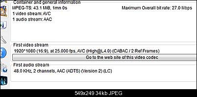

    Yep, I captured at 1980x1080i - I did try and change settings on Tivo to 720p but the capture file is even worse, very slow motion, then double quick speed-up and optical SPDIF input slows it to a crawl... I think Daily Motion downscales anything over 1080 to 720p unless you become a motionmaker as they like to put it.
    This is what media info says about my captured file;
    I was going to try and install each driver release one by one from here http://www.shspvr.com/ftp/download/colossus/ but when I switch PC off and reboot Windows automatically recognises card and installs driver 1.2.29291.0 18th Oct 2011
    I will try your suggestion with Win7 TV but I'm not sure it's processor problem because even with Hardware Accelator unchecked it only ever reaches 15%-20% utilisation. Also Win7 installs startup files and IR blaster which I won't need, but I'm willing to give anything a try!
