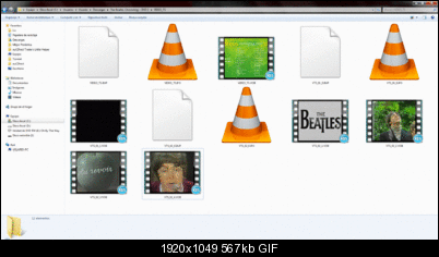

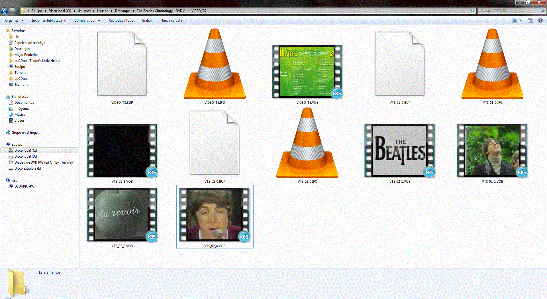

  23. Hello! I've got a problem with a bootleg Beatles dvd (or beatlef as they are called). When the dl finished as usual I dragged the folder to dvdshrink to se if it's OK before burning (no compression because it's a dvd 5) and got the following error.
    Next, I tried it on vlcmedia and as it didn't make any problem, I decided to burn it. When playing on standalone dvd players I get frozen and broken frames. What can it be? The guy who uploaded accidentally deleted the missing VTS_02_05.VOB?
    This is the folder

    Sorry the images got swapped. Thanks

  25. I'm a MEGA Super Moderator Baldrick's Avatar
    When does it start freezee? You can't just expect it to work with missing vob files. I would try reauthor or reconvert the dvd. With for example avstodvd.
    Or just try burn another media. Freeze problems could be because of a crappy dvdr.
  26. Thanks, Baldrick. It freezes at several points, but I would rhater say it jumps: broken frames and a moment later playback resumes a couple of seconds on from where it stopped. I'm using Sony dvd's made in Taiwan. I've been using them for a about 100 burns and normally they didn't cause trouble, the same goes for the burner. But you are right: I read the thread where it was posted and several users had problems with it. Apparently the uploader did a good job ripping the dvd because many of the pp who dloaded and burnt it had no problems. However, some of the pp whose first burn was bad went ahead and tried with a different dvd brand and some of the new copies were good and some were bad once more. I'm going to burn it in a diff dvd brand as soon as I can and will report back. I can't do it right now because Sony is all I have and Sundays everything is closed here in my hometown.
    I can't understnad why dvdshrink says there's a vob missing, I don't think the uploader deleted a vob before torrenting but who knows what he used to rip the dvd. When I play the dvd folder from hard drive on vlc it has very similar problems as well for example: I select a song from the menu and it plays it a minute and suddenly goes back to the root menu.
