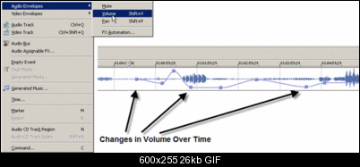

    If this was a dub from a pro produced TV program or movie, you would set to the loudest clip. If this is video you shot, you need to use audio monitors or headphones to set levels manually.
    http://www.eventdv.net/Articles/Editorial/Tutorials/Sony-Vegas-Tips-26-Tricks-Audio-No...tion-52451.htm
