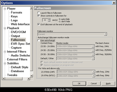

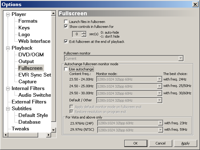

  8. MPCHC has auto scan rate adjustment that changes based on the source material's frame rate:
    I know of people who use this, for example, to eliminate 3:2 pulldown judder on HDTVs that support it.
    On a multi display computer you can force it to use a particular display for the video output and keep the playlist on the other display.
