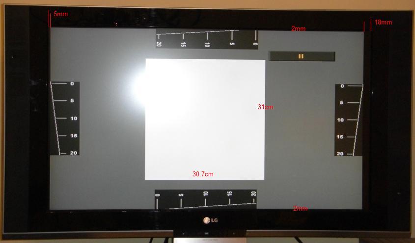

  12. This is a total mess!
    The TV's screen is x=82.3, y=46.3 cm. All mesurements were done by ruler / measuring tape.
    Both files looked exactly the same.
    I am attaching scart and hdmi pictures with the player set at 16/9 and 4/3. (4/3 letbox shows no difference from 4/3 panscan).
    As you can see, the 4/3 setting (of these files, not any files) fill more (not all) the screen.

  13. Originally Posted by drgt View Post
    I am attaching scart and hdmi pictures with the player set at 16/9 and 4/3. (4/3 letbox shows no difference from 4/3 panscan)... As you can see, the 4/3 setting (of these files, not any files) fill more (not all) the screen.
    That doesn't make any sense. In any case the 4:3 setting filling most of the screen is close enough. It may be that the player wants 720x576 instead of 704x576 to completely fill the 16:9 screen. Try this 720x576 16:9 DAR XVID AVI. Oops, I typed 24 fps instead of 25 fps. Should still work...
  14. Ok. This one plays almost like the other 2 on the player's 4/3 setting (again panscan or letbox does not matter).
    Line closest to 0 visible (HDMI):
    Left: 5
    Right: 0, except that the vertical black bar is now 10mm
    Top: 4
    Bottom: 3
    And I forgot to mention that all these are with the TV set at 16/9. If I put the TV on 4/3, it makes the picture smaller.
    Tell me if you want to see it.
    Well, if it does not make sense to you, for me it is CRAZY.
