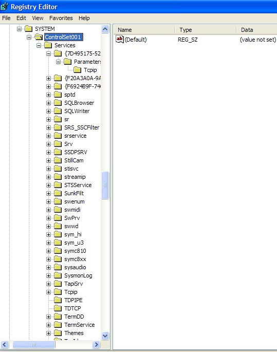

  12. PSCO2007
    May 2010
    Southern Ca.
    Originally Posted by jman98 View Post
    Originally Posted by Psco2007 View Post
    The IDE controllers are set to DMA and nothing else has changed.
    What exactly are you seeing that makes you say this? I don't remember the exact language of the phrase, but Windows has a setting that says something like "use DMA if possible" and that doesn't necessarily mean that DMA is being used. Your probably sounds suspiciously like a Windows XP PIO mode issue.
    When I go to device mgr and ide controllers and advanced, it shows all are in dma mode.
  13. PSCO2007
    May 2010
    Southern Ca.
    Originally Posted by d1spyky View Post
    Double check your IDE controllers, Primary (and secondary if available...), advanced setting tab, transfer mode is DMA and NOT PIO.
    If PIO mode, you need to delete and reset setting.
    Run -> regedit
    Find the following KEY:
    HKEY_LOCAL_MACHINE\SYSTEM\CurrentControlSet\Contro l\Class\{4D36E96A-E325-11CE-BFC1-08002BE10318}\000x
    The last four digits will be 0000, 0001, 0002, 0003, and so on.
    Under each key, delete all occurences of the following values:
    MasterIdDataChecksum
    SlaveIdDataChecksum
    Reboot the computer.
    Windows will now redetect DMA settings.
    Good Luck...
    I followed your directions, but do not see the settings you referenced.
Name:	REG EDITOR.jpg
    Jan 2008
    Assuming Windows XP...
    Regedit
    HKEY_LOCAL_MACHINE
    SYSTEM
    CurrentControlSet (not ControlSet001) <<<<<<<<<<<<<<<<<<<<<<<<<<<<<<<<<<<<<
    Control
    Class
    SlaveIdDataChecksum
    Reboot the computer. Windows will now redetect DMA settings.

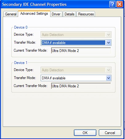

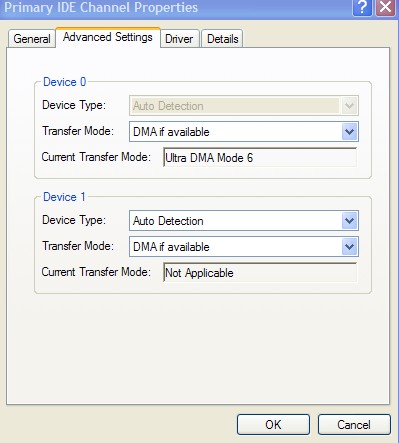

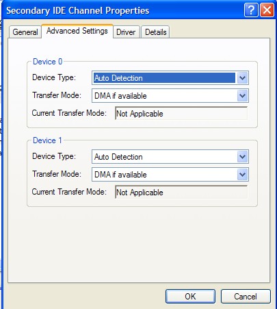

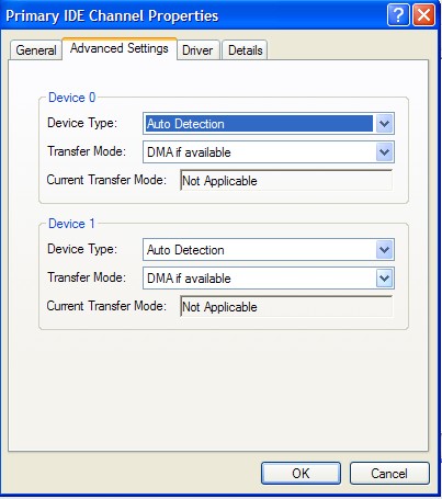

  23. PSCO2007
    May 2010
    Southern Ca.
    Hi,
    I had Imgburn reset the dma's and reboot.
    It is showing some IDE channels not showing dma in current transfer.

  24. The N/A's are just there because there's no drive attached.
    Did you actually test the speed using Discovery mode or have you not got that far yet?
  25. PSCO2007
    May 2010
    Southern Ca.
    Haven't gotten that far yet - have to leave now and will have to do it tomorrow.
    You also said there is no drive attached, but I have two dvd drives.
  26. Yeah and I expect they're the two covered by the 1st 'Secondary IDE Channel Properties' picture - the one showing 2 drives using 'Ultra DMA Mode 2'.
