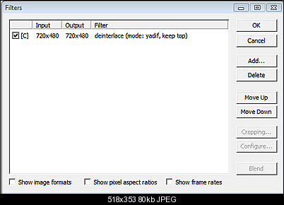

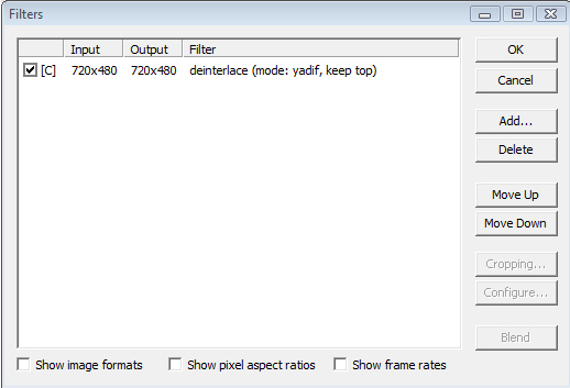

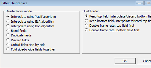

    - VirtualDub
    -- Filter
    = deinterlace (Yadif)

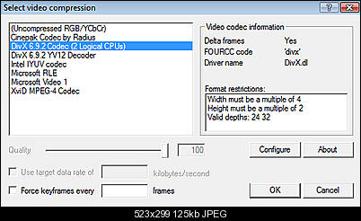

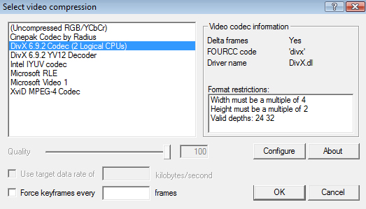

    -- Compression = DivX 6.9.2 Codec...

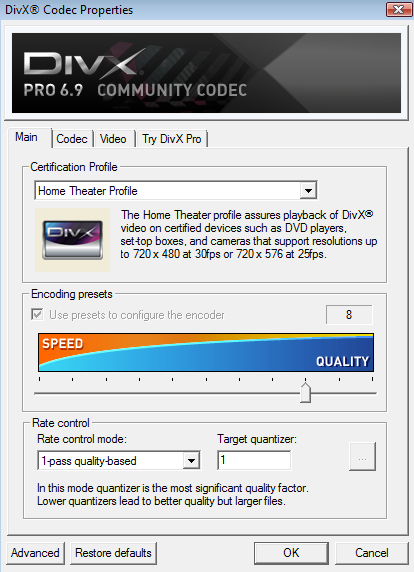

    ...configured to maximum quality (8), Home Theater Mode,
    Rate Control to "1-pass quality based" & set to 1
    With this I reduced the file from 6 GB to 900MB, but got that good-but-not-great quality.
    And this was after about 2 hours of test after test. Trying all kinds of combinations, codecs, filters, settings, etc. So, I did try hard and this was the best I was able to get.
