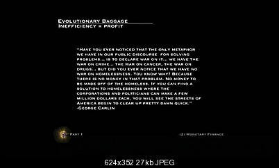

  6. now I understand why AutoGK gives an avg video bitrate of 423 kbps and avi file size of 538mb for 120min. This is a DVD wich contains a lecture comprised of a 4:3 slideshow type presentation with black background, centered whiting a 16:9 video, also with black background. Alot of black, alot of data between keyframes can be removed during compression. Even the source DVD has only 3,11GB for 120 min. The same lecture on Vimeo, encoded in H.264 at 360p, also has video avg bitrate ~500kbps.
    because it saw black at the top, bottom, left and right, and scenes in wich there is light in the whole frame are rare, it cropped too much, but after I've set treshold to 0 and nr of frames to examine = 1000, it didn't crop anything, or almost anything, I'm not sure...
