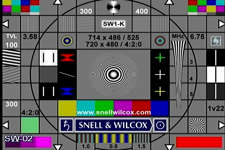

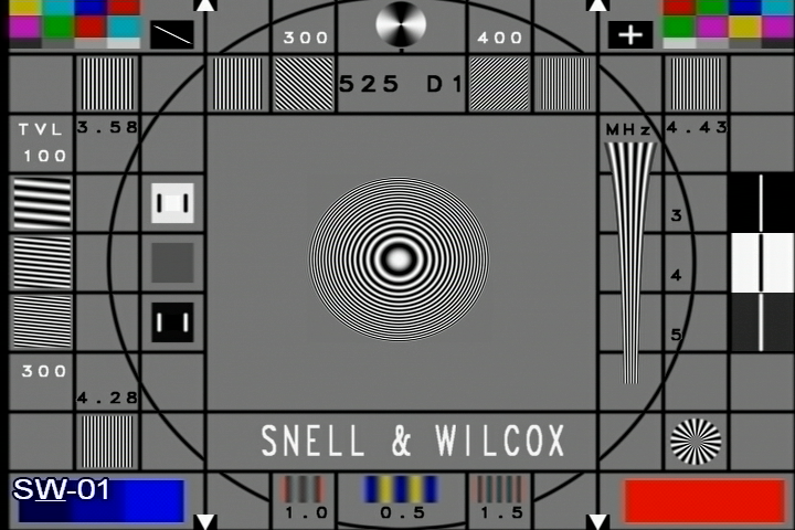

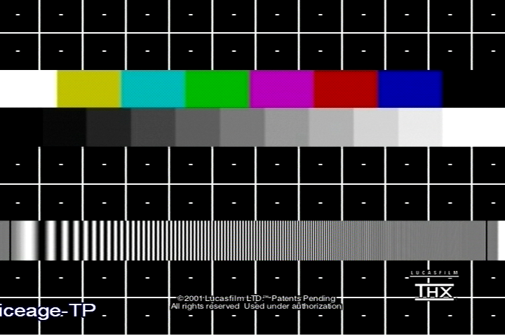

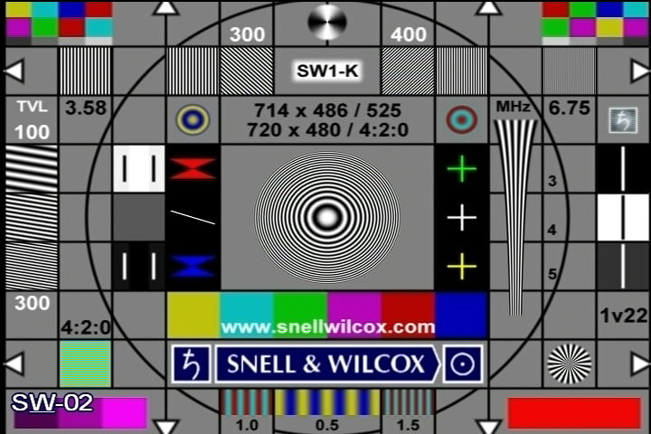

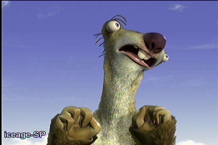

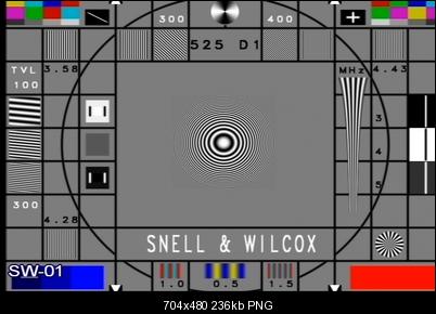

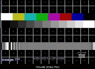

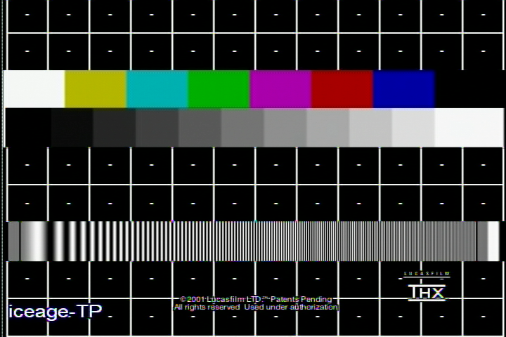

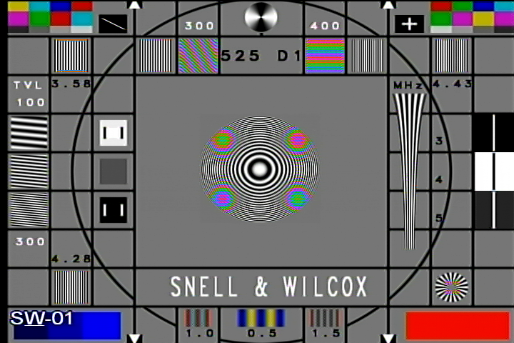

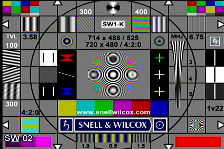

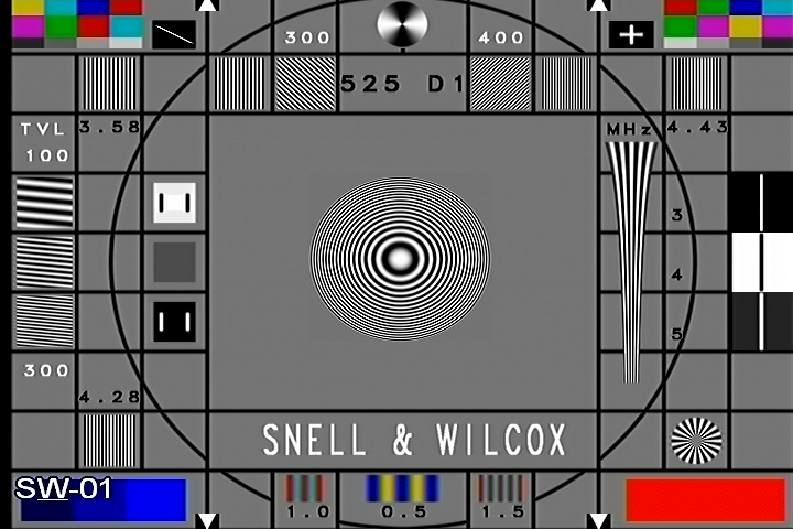

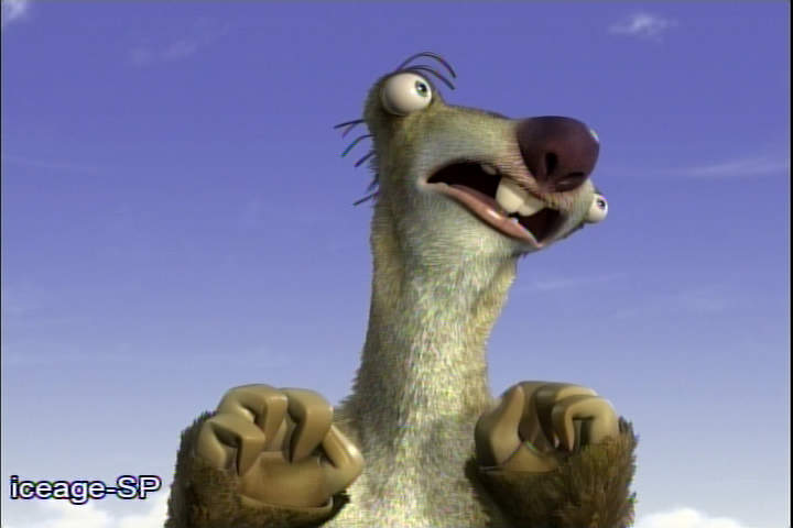

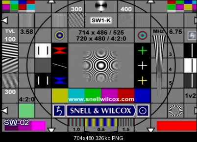

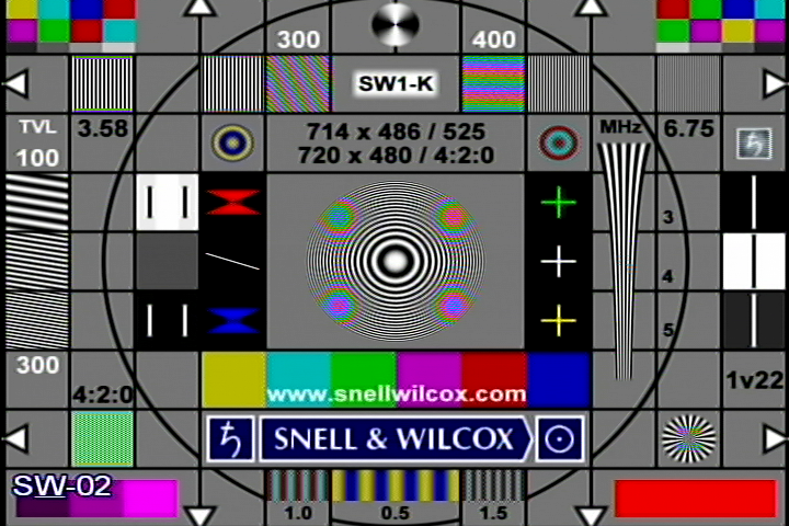

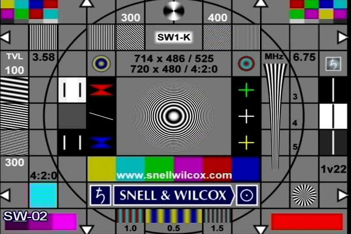

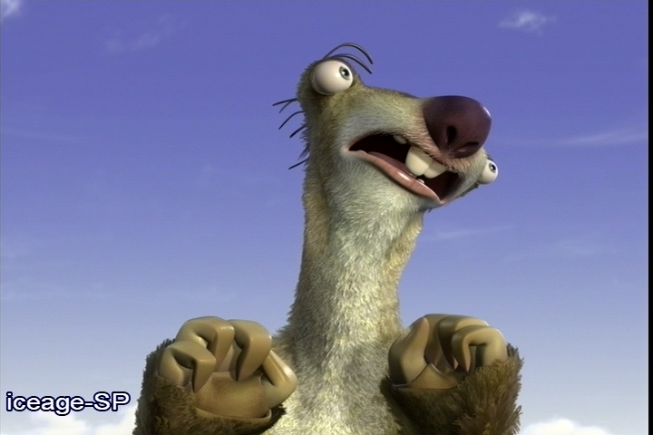

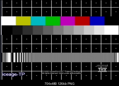

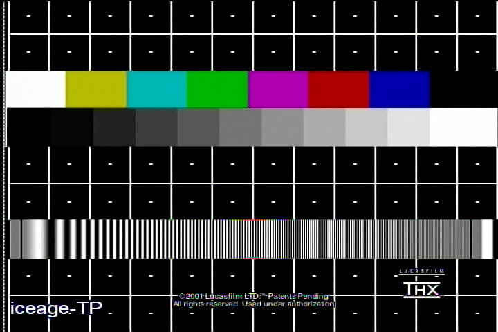

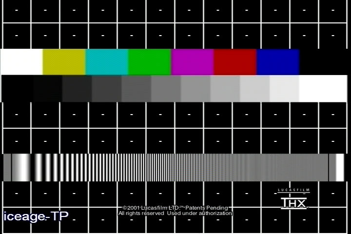

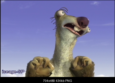

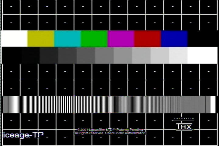

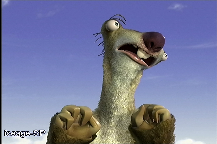

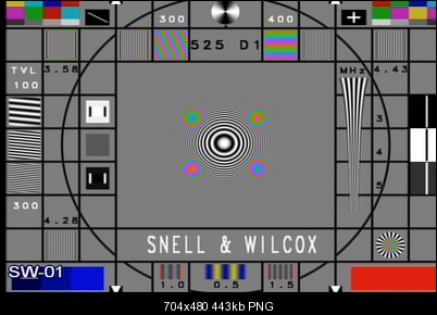

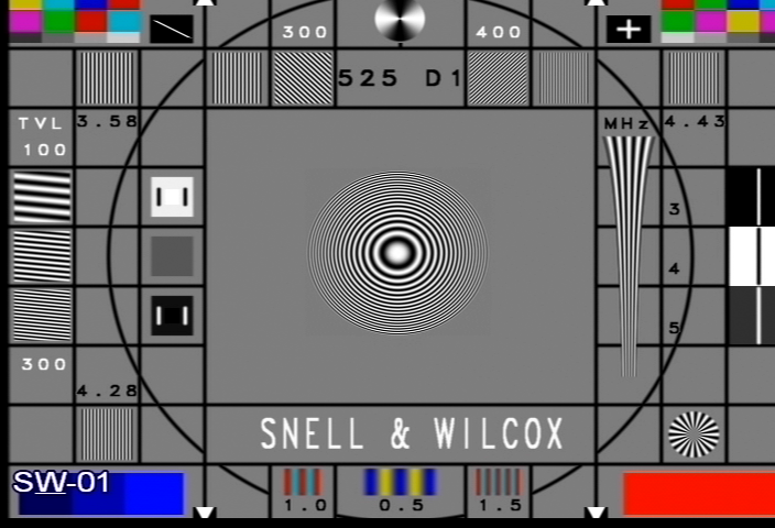

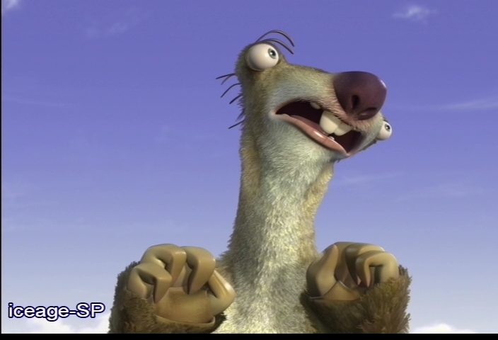

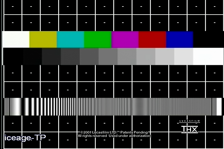

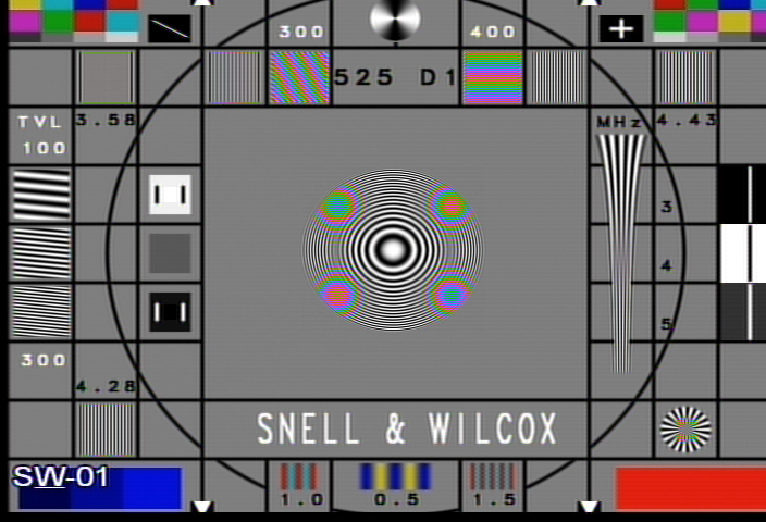

    Rounded up my four fully functional devices and did some comparisons. I used the instructions here except that my SW-01 shots are all from frame 90 rather than frame 30, in order to make sure that the player's OSD had disappeared. The VOB file used can be downloaded from here if you want to contribute your own comparisons. [Edit: Alternatively, I've now attached an ISO made from the file so you don't have to author it. The download is 1/3 the size because I used RAR instead of ZIP.]
    Played on a Philips DVP642, and I took two screenshots using my PS3 to see how much the player might affect the results. Except for the PS3, the cables used in each case were identical: a 5.5' composite cable that I believe came from a dollar store years ago and an S-Video cable that came as a pack-in with some equipment. I also compared this composite cable vs. a 3.5' entry-level "SV1" Monster cable but the differences were too negligible to bother posting any images. All were captured YUY2 using either Huffyuv or Huffyuv-MT in VirtualDub; the first two on Windows XP and the latter two on Windows 7 x64. For the 128 the driver used was dated 2001-09-26 and for the 9800 dated 2009-03-31. One thing I had forgotten until after I did the captures is that the 128 only seems to be able to do up to 704x480 properly. It's also a lot noisier than the others, though you can't see that in single screenshots. In all cases I used the default procamp settings and made no attempt to calibrate them for better accuracy.
    In addition to these devices I also have an ATI X1950 Pro with VIVO via the Rage Theater chip, but that sucker started having serious stability issues earlier in the year so I can't give it a go. The quality at least for composite was nothing special; plenty of dot crawl. I have an Iomega Buz around here somewhere too, but I don't think anyone is seriously interested in still using one of those.

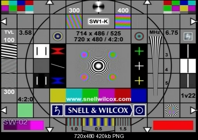

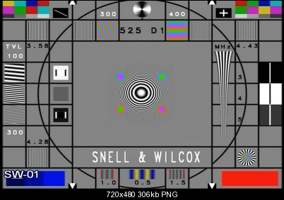

    [2013-05-14 EDIT: Replaced long-dead/screwed ImageShack links with attachments and added some AVR-890 HDMI images that are also found later in the thread. Replaced the ATI 600 Default shots with the ATI 600 shots where the Sharpness is correctly turned down to 0.]
    Composite
    AVerTV HD DVR (PS3 player)
Name:	SW-01 DVP642 HD DVR Composite.png
ID:	17852Click image for larger version
Name:	SW-02 PS3 HD DVR Composite.png

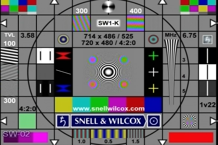

    ATI AIW 128 Pro AGP vs ATI AIW 9800 Pro vs ATI TV Wonder 600 USB vs AVR-890 HDMI vs AVerTV HD DVR
Name:	SW-01 DVP642 ATI 128 Composite.png
ID:	17854Click image for larger version
Name:	SW-01 DVP642 ATI 9800 Composite.png
ID:	17885Click image for larger version
Name:	SW-01 DVP642 ATI 600 Composite Sharp0.png
ID:	17849Click image for larger version
Name:	SW-01 DVP642 AVR-890 Composite - HDMI.png
ID:	17864Click image for larger version
Name:	SW-01 PS3 HD DVR Composite.png

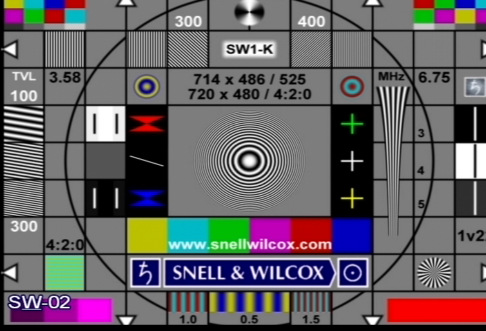

Name:	SW-02 DVP642 ATI 128 Composite.png
ID:	17871Click image for larger version
Name:	SW-02 DVP642 ATI 9800 Composite.png
ID:	17862Click image for larger version
Name:	SW-02 DVP642 ATI 600 Composite Sharp0.png
ID:	17866Click image for larger version
Name:	SW-02 DVP642 AVR-890 Composite - HDMI.png
ID:	17856Click image for larger version
Name:	SW-02 DVP642 HD DVR Composite.png

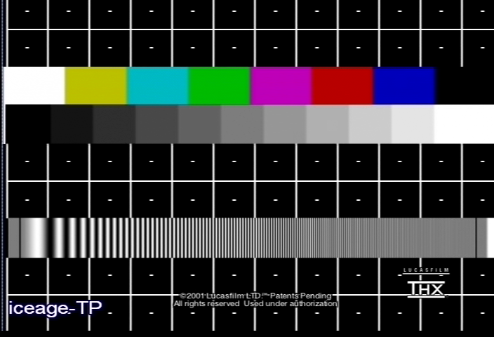

Name:	iceage-TP DVP642 ATI 128 Composite.png
ID:	17880Click image for larger version
Name:	iceage-TP DVP642 ATI 9800 Composite.png
ID:	17869Click image for larger version
Name:	iceage-TP DVP642 ATI 600 Composite Sharp0.png
ID:	17875Click image for larger version
Name:	iceage-TP DVP642 AVR-890 Composite - HDMI.png
ID:	17853Click image for larger version
Name:	iceage-TP DVP642 HD DVR Composite.png
ID:	17860Click image for larger version

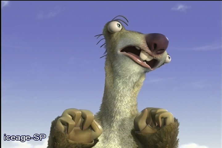

Name:	iceage-SP DVP642 ATI 128 Composite.png
ID:	17865Click image for larger version
Name:	iceage-SP DVP642 ATI 9800 Composite.png
ID:	17873Click image for larger version
Name:	iceage-SP DVP642 ATI 600 Composite Sharp0.png
ID:	17886Click image for larger version
Name:	iceage-SP DVP642 AVR-890 Composite - HDMI.png
ID:	17848Click image for larger version
Name:	iceage-SP DVP642 HD DVR Composite.png
    S-Video
Name:	SW-01 DVP642 ATI 128 S-Video.png
ID:	17872Click image for larger version
Name:	SW-01 DVP642 ATI 9800 S-Video.png
ID:	17850Click image for larger version
Name:	SW-01 DVP642 ATI 600 S-Video Sharp0.png
ID:	17867Click image for larger version
Name:	SW-01 DVP642 AVR-890 S-Video - HDMI.png
ID:	17851Click image for larger version
Name:	SW-01 DVP642 HD DVR S-Video.png
Name:	SW-02 DVP642 ATI 128 S-Video.png
ID:	17883Click image for larger version
Name:	SW-02 DVP642 ATI 9800 S-Video.png
ID:	17879Click image for larger version
Name:	SW-02 DVP642 ATI 600 S-Video Sharp0.png
ID:	17884Click image for larger version
Name:	SW-02 DVP642 AVR-890 S-Video - HDMI.png
ID:	17874Click image for larger version
Name:	SW-02 DVP642 HD DVR S-Video.png
Name:	iceage-TP DVP642 ATI 128 S-Video.png
ID:	17863Click image for larger version
Name:	iceage-TP DVP642 ATI 9800 S-Video.png
ID:	17888Click image for larger version
Name:	iceage-TP DVP642 ATI 600 S-Video Sharp0.png
ID:	17857Click image for larger version
Name:	iceage-TP DVP642 AVR-890 S-Video - HDMI.png
ID:	17882Click image for larger version
Name:	iceage-TP DVP642 HD DVR S-Video.png
Name:	iceage-SP DVP642 ATI 128 S-Video.png
ID:	17887Click image for larger version
Name:	iceage-SP DVP642 ATI 9800 S-Video.png
ID:	17868Click image for larger version
Name:	iceage-SP DVP642 ATI 600 S-Video Sharp0.png
ID:	17859Click image for larger version
Name:	iceage-SP DVP642 AVR-890 S-Video - HDMI.png
ID:	17858Click image for larger version
Name:	iceage-SP DVP642 HD DVR S-Video.png
    I also had an ADS Tech Pyro A/V Link a few months back, a Firewire box that encodes to DV. It died before I could do any proper comparisons but here are two with some PVR content that should give a rough idea, both via composite.
    ATI TV Wonder 600 USB vs ADS Pyro A/V Link
  2. Nice comparison. Can you access the proc amp settings on any those cards? Can you control the sharpness? The ATI 600 caps are over sharpened. I know, most people like that.
  3. Formerly 'vaporeon800' Brad's Avatar
    Apr 2001
    Vancouver, Canada
    Yeah, I noticed it too. All four of them have selectable proc amp sliders. The HD DVR card has no sharpness control, but the ATI 600 does. It's set by default at 2 and has a range up to 15 (which of course looks horrific). I haven't tested to see whether 0 gets rid of the ringing completely.

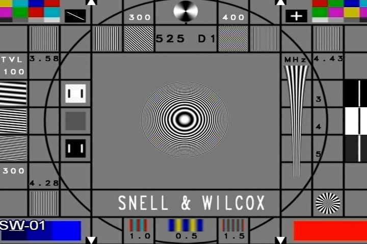

    ATI TV Wonder 600 USB, sharpness manually set to 0
    There's also a checkbox on the Video Decoder page for "VCR Input" but I can't figure out what it actually does when you check it, if anything.
  8. The ATI 600 caps look much better with the sharpness turned down to 0. Thanks for running the tests and posting the samples.

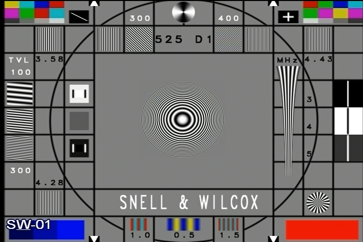

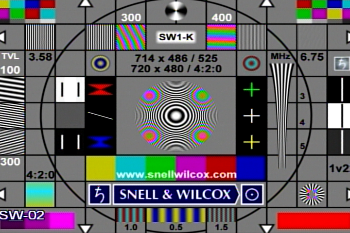

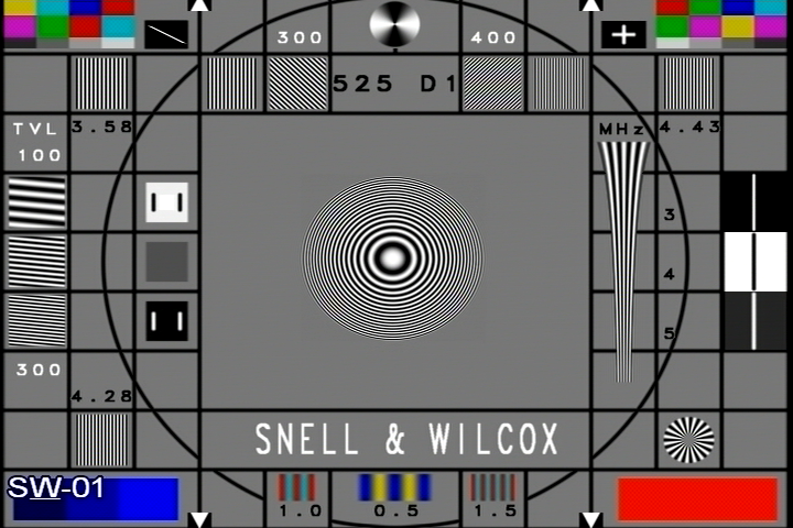

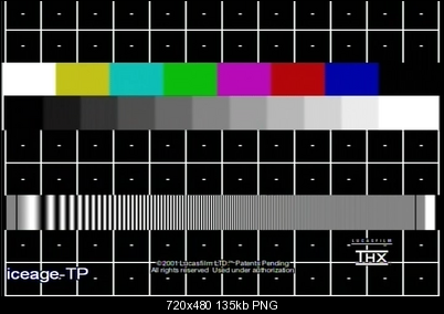

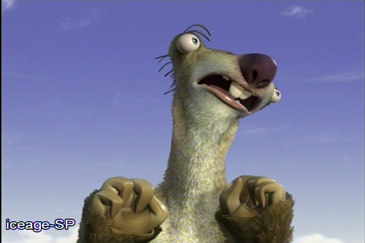

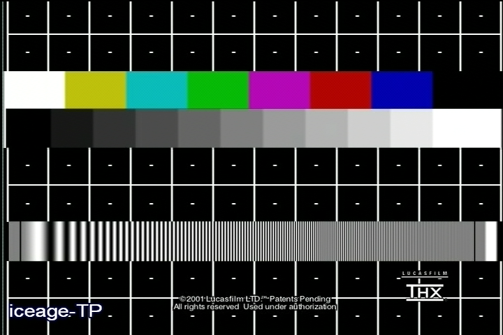

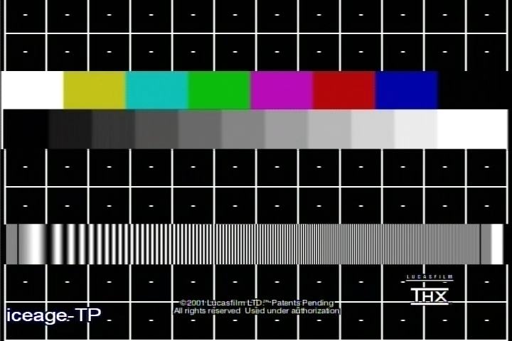

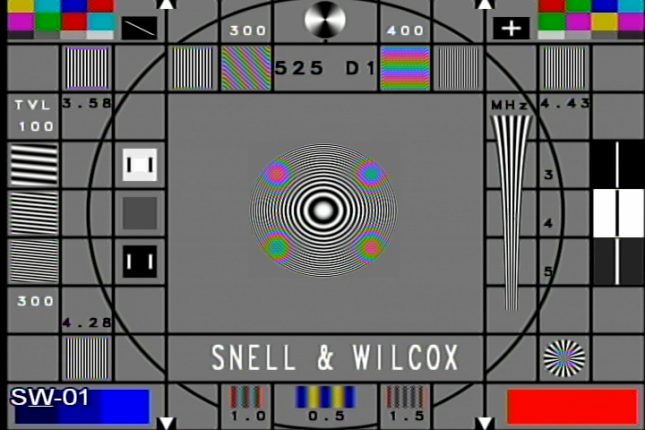

  9. I still can't get the proc amp working on my Hauppauge HD PVR (XP SP3, 32 bit) but the default settings aren't too far off. Here are samples with the low pass filters (noise reduction) turned to 0 (ranges from 0 to 20, 0 is sharpest), played from my Philips DVP5990, composite:
    The HD PVR was set to record at the highest CBR bitrate, 13.5 Mb/s. Since these were still shots, low noise, and only SD resolution it didn't achieve that bitrate. MediaInfo and Bitrate Viewer show about 1900 kbps.
  10. Formerly 'vaporeon800' Brad's Avatar
    Apr 2001
    Vancouver, Canada
    Thanks. Looks quite similar except for the higher brightness. I wonder how much of the lowered rainbowing is due to the AVC compression. I always found that MPEG codecs tended to remove some of it as part of throwing away data.

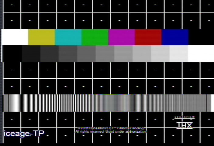

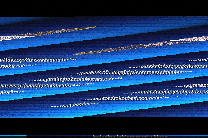

    Just want to post an update on this. The AVerTV HD DVR is nice for HDMI, but isn't suited to VHS captures, though they actually advertise that as one of its features.
    Firstly because of the non-defeatable sharpening. I thought this would be less of a problem on VHS than the test patterns, but I actually found it much MORE noticeable. It exacerbated the ringing already inherent in my VHS camcorder recordings from the early 90s to offensive levels. The same tape/VCR/etc. looks much nicer through the ATI 600.
    And then the other issue that I don't even understand which is that it has a tendency to drop to a black output when a VCR goes back to its blue screen OSD. While the tape is playing it's fine, but I tried two different VCRs so far and had this problem with both. It takes many restarts of the capture program to get the display to return when this happens.
  12. Originally Posted by vaporeon800 View Post
    I have the same problem with the card, its extremely sensitive to video levels and sync errors. A TBC is a must when using the analog inputs from videotape sources. The slightest dropout or sync issue on a tape will cause it to cut off video and screw up sound sync.

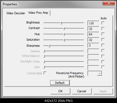

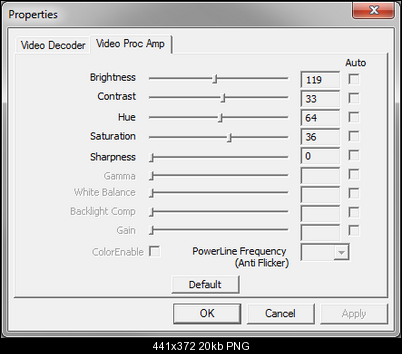

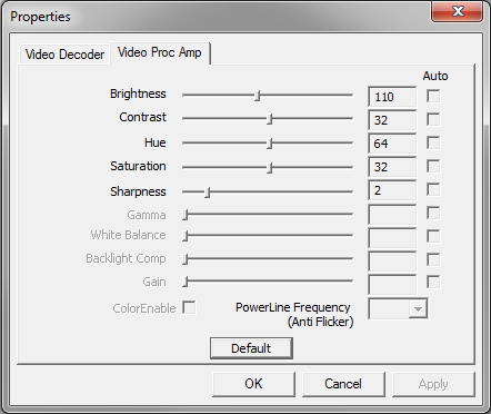

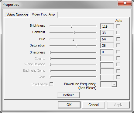

    Here's what I've come up with as far as calibrating the ATI TV Wonder 600 USB. It would be nice if there were a finer gradation for Saturation as 35 is too low but 36 is slightly too high. I left Hue at default because I found that fixing one color patch would throw another out of whack. It's a decent compromise value I guess.
    The default settings:
    Better settings:
    ATI TV Wonder 600 USB, manual settings
    There are a few other values that can be set in the registry that some may find useful. The potentially worthwhile VCR masking feature is ruined IMO by the fact that you can't just apply it to garbage at the bottom.

    The Proc Amp settings are stored in the registry, but can't actually be set by it. The settings on the Capture filter page somehow overwrite the reg values as soon as you start a capture graph again.
    For what it's worth, the TV Wonder HD 600 USB seems to be a generic device previously available from a few other manufacturers, eg one specific version of the Pinnacle PCTV HD Pro (but only the one with the AV cable bundled). On the other hand, the TV Wonder HD 600 PCI appears to use completely different chips, unless I'm blind. That would at least explain why one fellow said his PCI card suffered from the AGC issue.

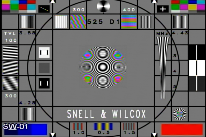

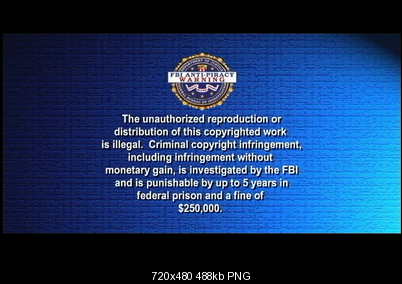

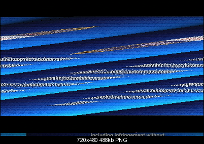

    Here's an example of Macrovision as detected by this device, both the commercial VHS tapes I've tried and DVDs. It randomly switches between okay and corrupted every few seconds. The specs sheet for the TI chip notes Macrovision detection among its features.

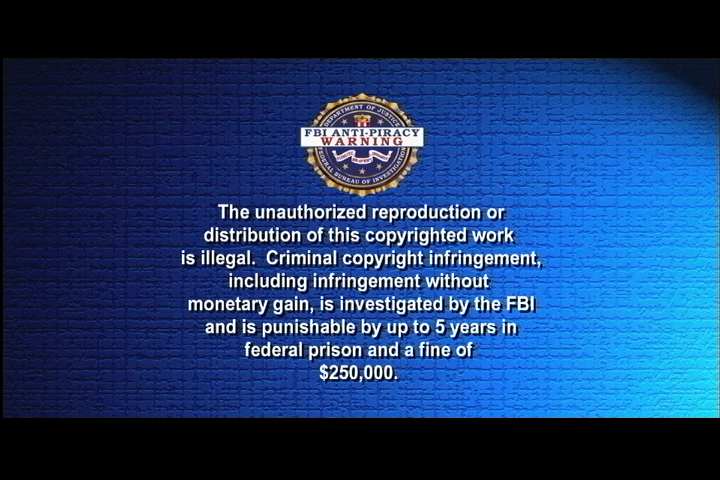

ID:	5788 Click image for larger version

    DVP642 --(analog cable)--> Denon AVR-890 --(HDMI cable)--> AVerTV HD DVR
    [These images are now in the first post. ImageShack deleted the links that were here.]
    I had a longer explanation typed out, but the forum software killed it when it decided to log me out for inactivity.
    I posted about this already on another forum/username; using the A/V receiver as a TBC so that I'm down to one analog/digital conversion step.
    ADV7480 is the chip used. It claims a 3D comb filter but that doesn't seem to be active.
    Resolution seems to be lower on the composite input than S-Video.
    Last edited by Brad; 17th May 2015 at 11:39. Reason: ImageShack nuked the images, but they're now in the OP anyway
  18. So basically you're now using the A/V receiver as your A/D converter and TBC.
  19. Formerly 'vaporeon800' Brad's Avatar
    Apr 2001
    Vancouver, Canada
    That's the idea.
    Something different. 1920x1080i comparisons using AVS HD 709 test patterns, played on a Insignia Blu-ray player. The component cable used came with my satellite receiver. It's very thick...
    In theory analog component should be equivalent to HDMI, but in practice I haven't seen that pan out. Mind you, I made no attempt to calibrate the brightness or anything else, but there's some things you can't calibrate like the capture window. I would be interested in Hauppauge comparisons.
    Warning: these PNGs are very large.
    NS-BRDVD4-CA --(component)--> AVerTV HD DVR (flickers on the high-res patterns)
    NS-BRDVD4-CA --(component)--> Denon AVR-890 --(HDMI)--> AVerTV HD DVR
    NS-BRDVD4-CA --(HDMI)--> AVerTV HD DVR

  24. Snapshots from my Matrox Marvel G400-TV (1999), which uses the Samsung KS0127 capture chip with the internal proc-amp setting at their defaults. Source DVD player is a Samsung DVD-S222. Captured YUY2 using HuffYUV at 704x480. The Windows 2000 driver for this card refused to capture any video at 720x480 giving only green output. Note that this same capture chip was used on the Rainbow Runner video capture add-on for the G200 series as well. One thing I did notice playing with this card is that using the onboard MJPEG encoder (Zoran ZR36060) screws up the color and levels giving a duller image. The images below are straight from the KS0127.
    Composite:
ID:	9270Click image for larger version
ID:	9271Click image for larger version
ID:	9272Click image for larger version
    S-Video:
ID:	9273Click image for larger version
ID:	9275Click image for larger version
ID:	9276Click image for larger version
  25. To add, here is a quick rundown of comb filtering performance of devices I have here using these test patterns. All had composite video inputted and S-Video output.
    3. JVC SR-VD400US DVHS VCR & AVT-8710 TBC (tied): Both show some dot crawl/rainbow effects with the Snell&Wilcox test patterns. The AVT-8710 claims to have a 2D line comb filter, the JVC's comb filter on its inputs is unknown but also likely 2D line. Performance is similar to connecting directly to the Aver HD DVR's composite input.
    2. Panasonic AG-1980: Shows dot crawl/rainbow effect for a split second on scene changes. VCR has a 3D adaptive comb filter and likely needs a few frames of video to work.
    1. JVC HR-S7800U: This VCR seems to have a 3D adaptive comb filter like the AG1980, but it doesn't show ANY dot crawl or rainbow effect on the S&N test patterns.
    If you have a Brooktree BT8x8 or 829 based card or the Matrox card, I highly suggest you use an external comb filter and use their S-Video input. The capture chips on those cards use a primitive notch comb filter on their composite inputs resulting in poor quality video. The only consumer level capture cards that have an excellent 3D adaptive comb filter built in are based on the ATI Theater chipsets.
    Ouch @ the cropping and noisy/low-res composite image.
    If anything is to be calibrated with the Denon, it's your source input. That, I think, is what you're referring to?
    The player itself doesn't have options for brightness/contrast/etc. Jagabo indicated earlier in the thread that calibration of A/D depends on both the feeding device as well as the conversion device and I've found that to be the case.
  29. Originally Posted by vaporeon800 View Post
    This card's claim to fame is that it can usually capture a VHS source without a TBC without dropping frames and its hardware MJPEG codec (capturing 720/704x480 at 29.97fps with HuffYUV with the IDE HDs and CPUs of that era wasn't possible). The drivers are a bit wonky though. The Windows 98SE driver has a more centered image (no black bar on the left of the test patterns) but it still chops off a little bit of the left and right sides of the image. The 98SE driver revision I have also doesn't support YUY2 capture, only RGB, but it can capture at 720x480 without a problem. Go figure. Oh, and this has to be one of the few uncompressed capture cards out there thats bottom field first!
