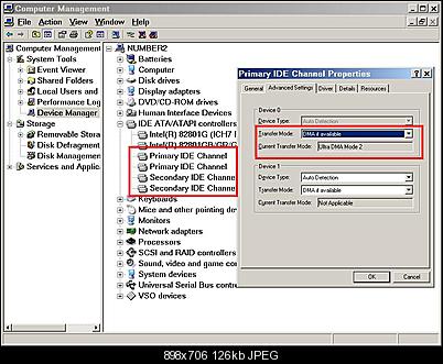

  4. Another possibility is that your hard drive has fallen out of DMA mode. You can use Device Manager to check the primary and secondary IDE controllers:
    If you see PIO mode try changing it to "DMA if available" and rebooting.

  6. Hi jagabo - in device manager I have 2 primary ide channel - 2 secondary ide channel - 2 standard dual channel pci ide controller
    My internal hard drive has a sata connection, one dvd rewriter has a sata connection and another has an ide connection. When I was installing windows I didn't have a floppy and wasn't really ready for it when it asked for me to install a floppy disc so I'm assuming I didn't install the sata drivers. Although there was a bit of me that hoped things had moved along and some how I would be able to load the drivers from the mobo disc that I ran once windows was installed.
    The settings on the first listed primary ide channel is PIO mode but it won't let me change it manually - settings in the second listed ide channel are (current transfer mode - not applicable). Settings in the first listed secondary ide channel is Ultra DMA mode 5 - settings for the second listed secondary ide channel is (current transfer mode - not applicable)

  7. Originally Posted by persephone View Post
    My internal hard drive has a sata connection, one dvd rewriter has a sata connection and another has an ide connection... The settings on the first listed primary ide channel is PIO mode
    That could be the problem. Were you copying from the IDE drive to the USB drive when you got the slow transfers?
    If you can't manually select "DMA if available" or if you can select it but the computer reboots in PIO mode, the usual fix is to uninstall the driver (right click on the primary IDE channel and select uninstall) and reboot. Windows should reinstall the driver and use DMA mode. Windows includes drivers for common IDE controllers so you usually don't need drivers from the manufacturer.

  8. Now that is much more like it - did as you suggested and uninstalled the driver and rebooted and I've just copied a 1.7 gig file across using firewire in (drum roll) 1 minute 21 seconds. Before uninstalling the driver i copied a 1.4 gig file across and it took 16 minutes via firewire.
