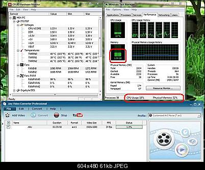

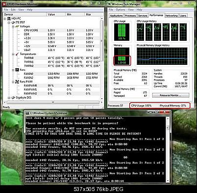

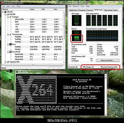

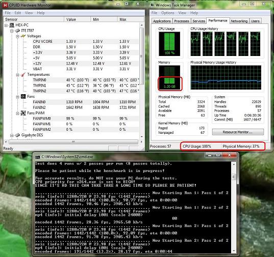

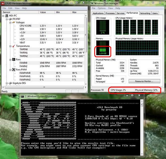

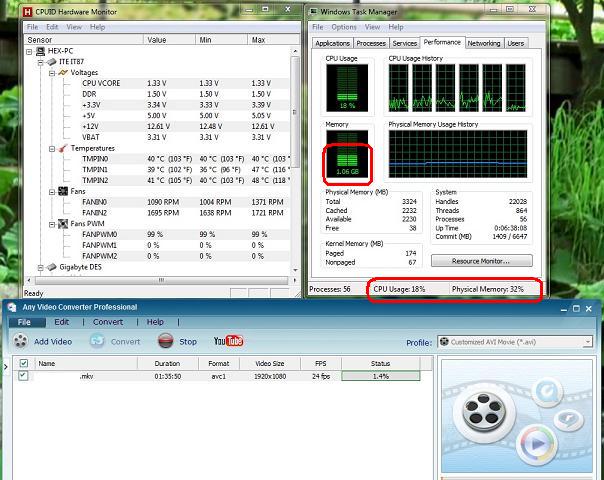

    Here's a quick comparison of MPEG and H.264 encodes. The information here probably isn't really accurate and it's not meant to be a particularly valid comparison, but note the amount of RAM and CPU used with these encodes vs idle. Not much RAM in use compared to idle, even at 100% CPU.
    I'm really not that familiar with Intel CPUs to give a good comparison between those two. But others here probably can.
    All modern CPUs, AFAIK, are 64bit, so a 64bit OS wouldn't be a problem. No idea about 'Win 7 Live CDs'.
    IDLE: CPU usage=2%, Memory=32%, RAM usage=1.04GB
    MPEG: CPU usage=18%, Memory=32%, RAM usage=1.06GB
    H.264: CPU usage=100%, Memory=37%, RAM usage=1.20GB

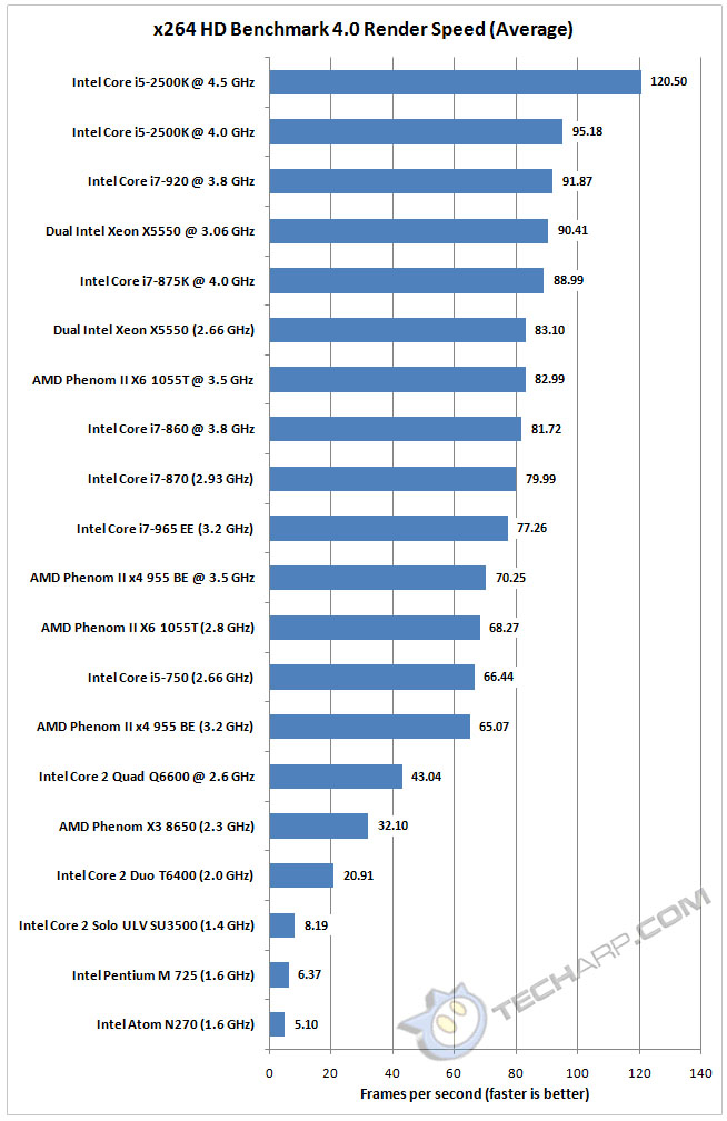

  12. In general, the more cores you have, the more power you will have in video encoding. I have a 6 core Phenom II x6 1090T, and it flies through H264 encoding.
    You can see this benchmark here, that the AMD 6 core cpu's can hang with the Intel core i7's :
    http://www.legionhardware.com/articles_pages/amd_phenom_ii_x6_1090t_be_1055t,5.html
    Most gamers prefer the 4 core phenom II's, and Intel processors, but when it comes down to encoding, the AMD 6 core cpu's are powerful, and nicely priced.
    I was about to buy an i5 750 system last year, but at the last second I saw the release of the AMD 6 core cpu's and I knew the amd hexacores would be my choice after seeing similar video encoding benchmarks.
    Nov 2002
    In the benchmark you posted, the I5 is equal to the 6 core in the H264 Benchmark and smokes both the 6 cores in the TMPGEnc benchmark.

    This is from the X264 benchmark forum...
    http://forums.techarp.com/reviews-articles/26363-x264-hd-benchmark-4-0-a.html
    Showing these results...
    x264 HD BENCHMARK 4.0 RESULTS
