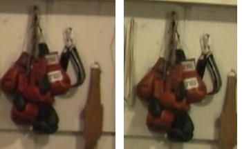

    Here is an example of the color change. The red gloves on the left side are brighter and come AFTER Virtualdub has rendered the file. They've changed the color from the original colors on the right side. I'd rather keep the color the same to maintain uniformity throughout the video (even though Virtualdub's color is actually better).
    Any thoughts?

    How are you taking screenshots ? What is your process and software used ? How are you loading the video into vdub ? What decoder are you using ? What filetype is the Left and what is the Right ? (was it taken in vdub, or an export with screenshot in another application? )
    Just a simple screen shot (print screen and paste)
    A file that came directly from a digital video important (Panasonic PV-GS500).
  12. Need to be more specific. The renderer, decoder and RGB conversion used affects how the video is displayed
    How are you viewing it, before you take the screenshot? (ie. what is the screenshot taken of)
    Do you have more than 1 media player open or video application open simultaneously?
    What format did you export from vdub ? When you use filters in vdub, it does an RGB conversion - so this might be where the difference is
    This is a DV camcorder , correct? There is no combing in the frame so some deinterlacing filter have been applied ? Was there any other processing other than crop or rotate ?
