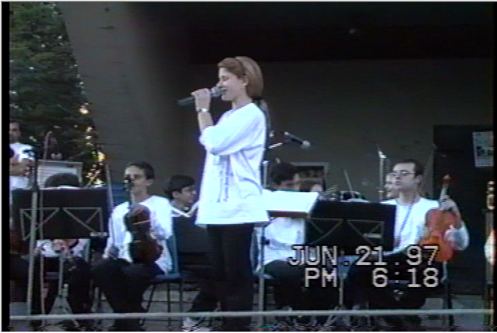

    Since youtube removes a lot of detail, I posted a sample below in huffyuv format, straight from the capture video without any modifications. I have no experience with avisynth but will look into the suggested deinterlacer filter.
    Also, for the chroma noise next to the white clothes, what filter could be used?
    Also, is the video sample below good enough material to produce decent results? Would I be better off recapturing with a VCR with TBC, or wouldn't make too much of a difference?
    Thanks a lot!
    Carlos
    Last edited by cfelicio; 2nd Dec 2010 at 21:35. Reason: added a screencap as recommended

    Adding a screencap

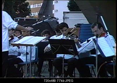

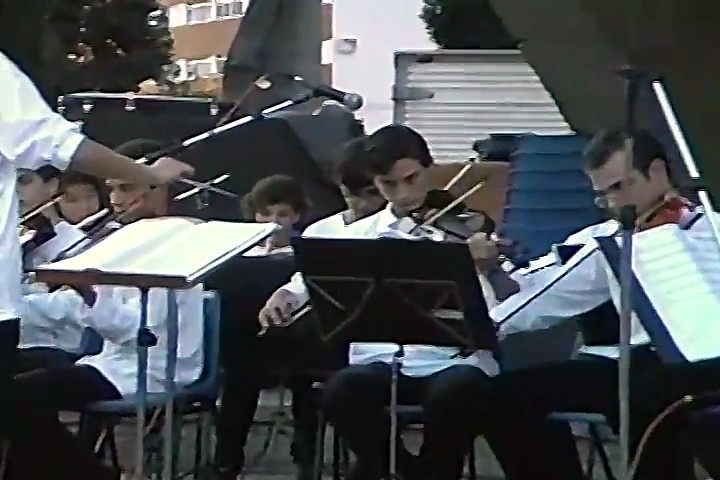

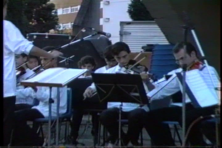

  15. The MPG clip is much better and has brights that can be salvaged. I turned the luma gain down a bit in AviSynth then used VirtualDub's Gradation Curves to adjust the colors. It's still not perfect but much improved:
    original:
    adjusted:
    from your youtube FLV:
    For making a DVD you should leave the video interlaced. If you're going to perform a lot of filtering like this, and you have to capture as MPEG 2, I would recommend you capture with the highest bitrate the software lets you. Even better would be to capture YUY2 and losslessly compress with HuffYUV. The intermediate files will be big but they will be free of MPEG artifacts.

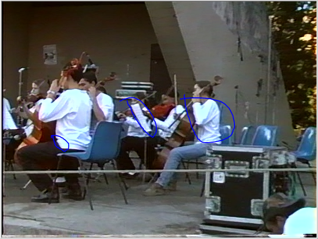

    Thanks so much for the suggestions. I didn't get to play with deshaker yet, but here is the script I got so far for converting my videos:
    SetMTmode(5,0)
    DirectShowSource("testclip.mpg")
    ConvertToYV12(interlaced=true)
    AssumeBFF()
    SetMTmode(2)
    QTGMC(Preset="Slow")
    SelectEven()
    ColorYUV(autogain=true,autowhite=true)
    Crop(8,0,-8,-0)
    LanczosResize(640,480)
    FFT3DFilter (plane=3)
    LSFmod(strength=120)
    And here is the result, which is MUCH BETTER than my original conversion, thanks to all of you!!
    Can you please have a look at the screenshots and (if possible) at the video, and suggest further improvements / corrections to the script above? I will later change the autogain / autowhite once my colorimeter arrives, so these can be kept for now.
    I noticed chroma aberration is so much better now, but still visible at some parts of the video (look at capture 2). I tried to use mergechroma(awarpsharp2) but didn't see any difference, any other ideas?
    Also, I used lanczos to resize, but also heard about spline, which one is usually better? Also I must say I noticed a HUGE difference in the video aspect ratio, much better now at 640 x 480, thanks for the hint!!

  26. 1) be careful about using directshowsource() with temporal filters , it's not frame accurate and you can get mixed up frames . It may occur with things like QTGMC . I would use DGIndex and DGDecode.dll instead
    MPEG2Source()
    2) You still have chroma noise in the screenshot, you might want to increase fft3dfilter strength for chroma denoising, or tweak it to your tastes
    FFT3DFilter(plane=3, sigma=4, bt=3)
    3) I think you've might have introduced "flickering" with the auto filters, there seems to be big jumps in frame to frame luminance in the video sample
    There are different types of lanczos and spline
    e.g. spline16 is softer than spline36
    e.g. lanczos4 is very sharp compared to lanczos (both produce ringing)
    There are a few others too, spline64 etc...
    spline36 is comparable to lanczos, but very slightly less ringing
    I don't think it's actually chromatic aberration (in the sense of caused by a lens).
    The residual stuff is tough to handle in avisynth . It's very diffuse and blurry. So it may improve some areas but make other areas worse. You can try to improve it before using fft3dfilter (because chroma denoising will make it more diffuse) , and play with the parameters. I don't think you will improve it much
    MergeChroma(aWarpSharp2(thresh=204, type=1, blur=24, chroma=4, depth=32))
    Even with other programs it will be tricky (e.g. if using masks or secondary color correction), because the range of hue beside the "blue" chairs shares too much similarity. If you remove it, you remove the "blue" from chairs as well. In contrast, the "teal" glow in the bottom right of the screenshot is easy to remove, because it's hue range is different from the "blue" chairs.
  27. Video Restorer lordsmurf's Avatar
    It looks to be blooming from the video signal, not CA.
    The leaves don't have CA, and CA tends to be an edge issue more than center.
    So I agree with poison.
  28. You can improve the flickering by using some deflickering filters. Donald Graft's deflicker in vdub seems to work ok on your sample clip (there are others as well - several in avisynth and msu has a plugin). Another approach would be to use manual white balance and color correction. The problem with some "auto" filters is they look intra frame only, and not temporally. So luminance changes across frames can be dramatic, and scene changes and fades can be very poor. I don't think there is a temporal component to ColorYUV() - it's only spatial per frame
    PS . I wouldn't bother trying to fix the color fringe or the "bloom" or whatever it is in avisynth. It's too diffuse. Those 2 suggestions will only help with thinner color fringing. If you have access to other programs like AE, you can get rid of the teal fringing easily. But the blue fringing by the blue chair is difficult to isolate by color - so you would have to do manual rotoscoping and masks to isolate it
  29. Video Restorer lordsmurf's Avatar
    The damage is uncorrectable, for the most part.
    It's generally a mix of optical and signal. I see it on film and video.

    Hi All,
    Thanks a lot for the feedback!
    I made some changes to the script based on that:
    MPEG2Source("smalltestclip.d2v")
    AssumeBFF()
    Crop(8,0,-8,-0)
    Spline36Resize(640,480)
    SelectEven()
    ConvertToRGB(matrix="PC.601")
    So, I removed the setMTmode as I got some "livelock" on Virtualdub. Now it is running a bit slower, but nothing is freezing.
    Also, I think it's easier to fix highliths / white balance on virtualdub later, so I added converttorgb (with pc.601), this will preserve the highlights so I can recover them later, right?
    Regarding the crop, I want to crop a bit more because there's still some garbage at the bottom of the video, will that influence the resize in any way? The only thing is that I need to keep it multiples of 4 (since it's in YV12 colorspace), right?
    Thanks!
