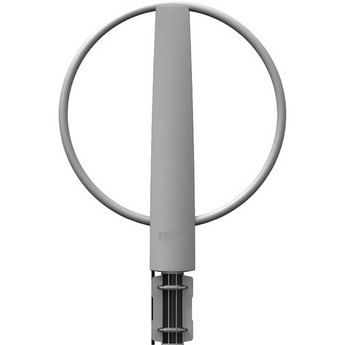

    I have a three story 3700 sq ft home... I am looking to upgrade my HD antenna. I have four satellite receivers and two LED & Plasma TV's and also a stereo receiver that has HD radio. So I will have seven or more things to split to. Will this antenna I have listed here work for my needs? I want to be able to split it to all of these and have no connection issues in strength. Will any HD antenna work for FM/AM HD radio?
    http://www.amazon.com/Terk-HDTVO-Amplified-HDTV-Antenna/dp/B0009W9WHQ/ref=pd_sim_sbs_e_8

    That antenna is fairly small from what I remember. Whether it's a good choice or not depends on where you are in relationship to the stations you want to receive.
    Check TVFool.com or antennaweb.org to see where the stations are located. They have color codes for each station that indicates what class of antenna required for it. That antenna is coded blue.
    You may need a distibution amplifier in addition to the amplifier provided with the antenna for that many splits.
    A lot of people find they need separate antennas and cabling for radio and TV. FM can sometimes interfere with a TV signal, and some people add an FM trap for that reason. Some outdoor TV antennas even have a built-in FM trap.

    Thanks. This is the distance for most of my stations (25 miles looks like). I have this antenna right now. But it only works with one tv can't be split even with a amplifier. Also I will be placing it about 30 ft high on my roof then I have this one.
    http://www.monoprice.com/products/product.asp?c_id=109&cp_id=10901&cs_id=1090102&p_id=...seq=1&format=2

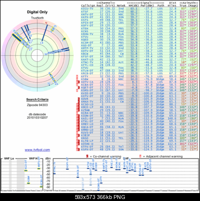

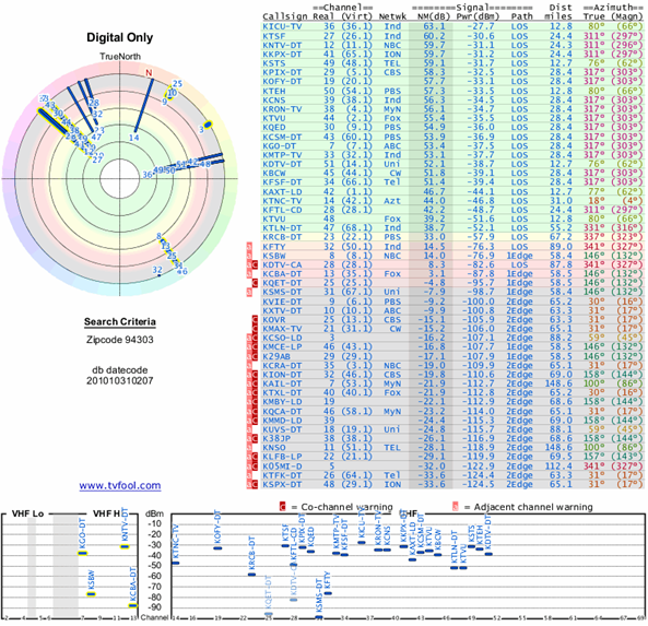

    Fill out the TV fool address info and post the result. It won't have your address.
    OTA reception depends on direction, distance and obstacles in the path (e.g. hills, trees, buildings) to the transmitting tower.
    This is a typical urban TV Fool plot. Antennas required depend on the stations you want to receive.
