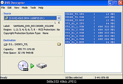

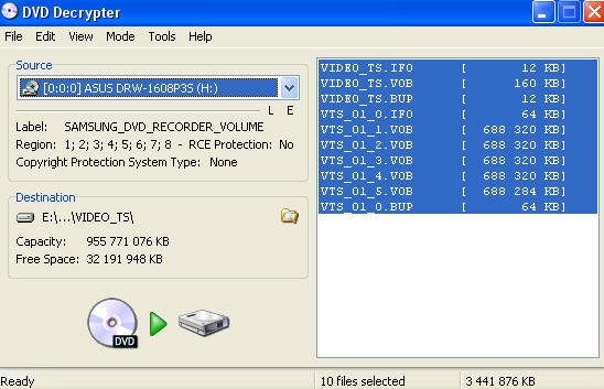

    I have record from VHS to DVD-R. And now I want to add subtitles to this DVD. The first thing is the strange size of the VOBs:
    The audio and video are synced perfectly on original DVD-R. But when I demux them and then mux with additional sup file I get progressive out of sync between video and audio. I used different programs: Ifo edit, Muxman, Mpeg-vcr, vob-edit, pgc demux. I even tried to create DVD in Nero and correct errors in Vobblanker. But the result is the same. It's a problem of video and I don't know what to do.

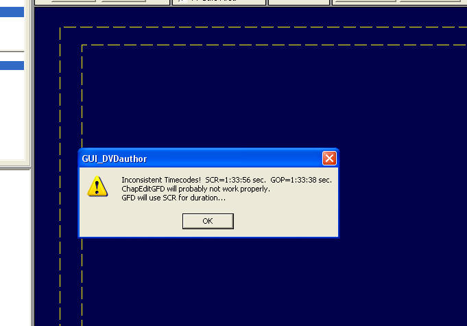

  3. Thanks for the reply. I used the programs you mentioned and got this error. This seems to be the cause of out of sync. Do you know how to fix it?
