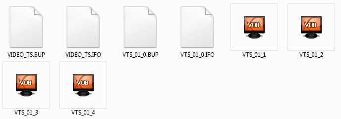

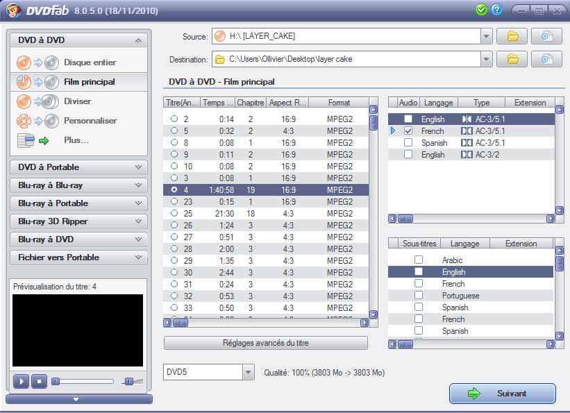

    PS : After rippinf my DVD with DVDfab, I ended up with 8 files, why ? is it because of the chapters ? I never understood the structure of a DVD... (see the pics attached)

    The video, audio and subtitles are int he VOB files, the details about aspect ratio, track numbers, chapters etc are int he IFO files. The BUP files are backups of the IFO files. This is what a DVD looks like.
    If you have just demuxed the audio, then it will be whatever was in the original. Demuxing on it's own does no conversion.

  8. That's odd, on my picture, i can read "French | AC-3/5.1" I wonder why it extracted only 2 channels...

    I don't believe DVDFab actually looks at the audio tracks, but gets the channels form the IFO file. If they are mis-labelled (not unheard of) then it will show you the wrong details.
    What method did you use to demux the audio ?
    How are you assessing the number of channels ?
    What does mediainfo say about the AC3 file ?
    Read my blog here.
  10. Well, on the original box, it's writtien "french, spanish, english, Dolby Digital 5.1"...
    Actually, mediainfo says it's 6ch... no problem then !
