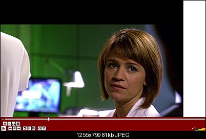

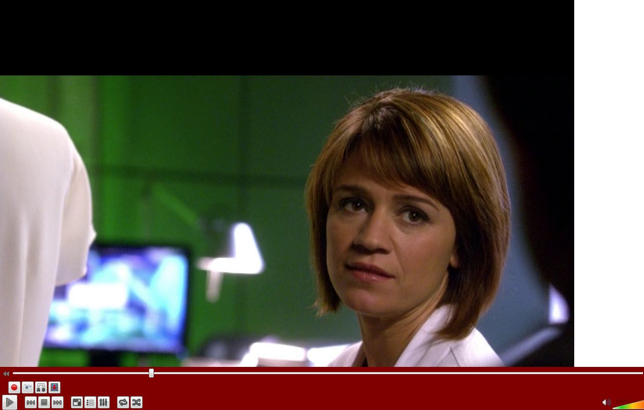

    I noticed vlc has a really poor image quality compared to WMP when I watch 720p tv show's and it really bothers me, cause wmp has a lot smoother and colorful picture....I attached the screenshoot and as you can see vlc has a bit of a grainy image and I'd like to have it as clear as on WMP, so please tell me what to do? I tried other outputs, but none comes close to this in wmp...maybe if I could know how wmp is set I could set vlc in settings the same, but I don't so please help...I don't wanna stop using vlc just because of that, cause wmp has a really quiet sound when watching hd (even when having all volume settings on max) and vlc is my only option.
    VLC
    WMP
    so you see picture diferrence is VERY annyoing and noticeable...wmp feels like real one while vlc is like so artificial =/

  3. wmp uses a different decoding chain - directshow. That directshow decoder may apply post processing (smoothing) depending on what the source is (if it's wmv it does for sure)
    vlc cannot access it - it's not a directshow player, only directshow decoders can access it (eg. mpc, mpchc, wmp, bsplayer etc..) . VLC uses libavcodec to decode
    The other differences in color - vlc uses rec.709 conversion to RGB (which is correct for HD material) , but wmp is using rec.601. This is most noticable in reds/skin tones
    If you prefer WMP's decoding, then use WMP or a directshow player. Some of them have audio options like normalization so you can use them instead if the low audio is a concern. Depending on what directshow decoder you are using for audio, you can enable filters like audio normalization as well.

    look above her eyelid and fringe, the difference in details is clearly visible...vlc distorts it totally..also look at her skin on the right cheek and the make up, wmp has it clear and shiny as it should be while vlc shot is really poor

    I'm playing a mkv file here and I have all codecs installed (k-lite codec pack full) also about the color, is there a way to change .709 setting to .601 as in WMP?
    I managed to get a bit better pic quality by ticking use system codecs if available, but still it's not as smooth and it's just a tiny bit more pale, so I think I could also play around with brightness and contrasts filters no?

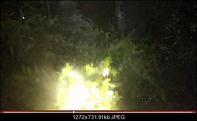

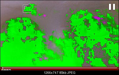

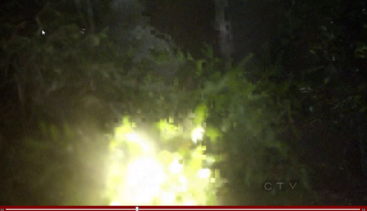

    though I got a problem now, when I change sliders, the picture doesn't change at all...maybe because I'm getting those 'squares' when fastforwarding and also when I stop fast forwarding pic it still ffw's for about a sec, so I don't know what's wrong with it? also if I fast forward a few times when on pause, vlc just freezes and I have to close it by ending process in task manager...
    maybe, that's cause I ticked to use system codecs if available? but I need this as pic is slightly better now...
    here's a screen of those 'squares I'm talking about

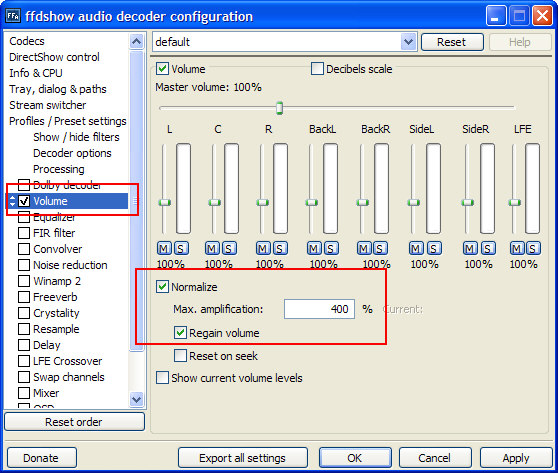

  7. and I don't know how I can set my audio louder on wmp as I already have all to the max and it's still quiet.
    what is the audio? ac3? what decoder for wmp ? you can adjust the audio in the decoder (e.g. if you are using ffdshow, select normalize audio, if you are using ac3 filter I think you can adjust the volume as well

    however, here's a screen of how I improved the pic by ticking 'use system codecs if available'
    you can see the image quality and details are a lot closer to wmp, but still color is a bit off that's why I said I could play around with filers, only I need help now regarding those 'squares' I mentioned as I can move sliders however I want, but pic won't change...you can also notice when I took this screenshoot and I moved vlc window around to resize it that the picture didn't expand, but there just appeared those black edges, because those squares make the pic freeze or something...hopefully you understand what I mean

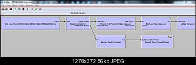

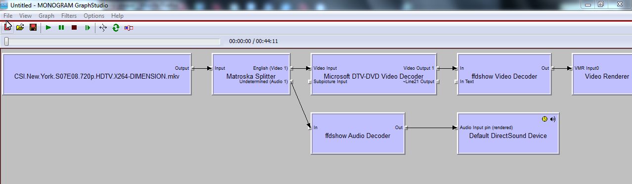

  13. installed graph studio now, so lets forget about mpchc...gonna fix wmp audio instead, so please help me with rendering you mentioned before
  14. in graphstudio, file=>render media file
    the boxes will connect the pins and show what direct show decoder is currently being used
    if it's the microsoft decoder on win7 you have to use preferred filter tweaker to select ffdshow or ac3filter (you cannot adjust the ms decoder)
    https://www.videohelp.com/tools/Preferred_Filter_Tweaker
  15. ok, got it...I rendered the media file I'm currently playing, hopefully I did it right, here's a screenshoot
    so it says default direct sound device...what do I have to do in wmp then to have louder audio and where to go?
  16. Just drop your video onto the GraphStudio Window.
    Oops, too late.
  17. it says ffdshow audio decoder.
    in the ffdshow audio configuration you can use amplify or normalize or adjust master volume. You have to checkmark the box to activate it (under "volume"), push apply and ok. You can adjust it to your tastes

  18. Originally Posted by poisondeathray View Post
    got it. pulled the master volume to 400% at first and sound was very bad, so I lowered it to 200% and I got my volume like on vlc now. yay! thank you!
