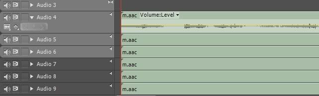

    I have inputted the 6 channel audio track into premere and adjust the audio, now in the preview window, they are sync.
    But when I try to output the adjusted audio, premere gives me error message by saying that I am outputting channels
    larger than the original, but I only choose to ouput 5.1 channel, that is equal to the original one, then why is there still
    an error?
  8. In your sequence settings, did you select 5.1 for master audio track ?
    Why are your channels broken out ? Was the original 5.1 (1 track), or 6 mono tracks ?
    If all you are doing is manual sync (not individual channel work), 5.1 can appear on 1 track and you can export it as 5.1 single track

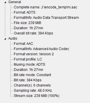

    I don't know whether it is exactly 5.1 channels or not, this is the properties of the audio file
  10. yes it's (5.1) is the same thing as 6 channel aac - but it should import as 1 track , not 6 mono
