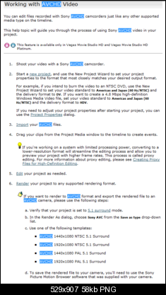

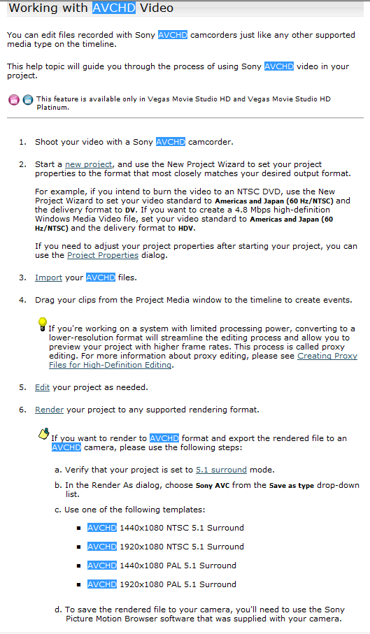

    You will need to upgrade to Vegas Platinum or Pro versions 9 or 10 to get AVCHD support. Here is the overview help file ...

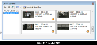

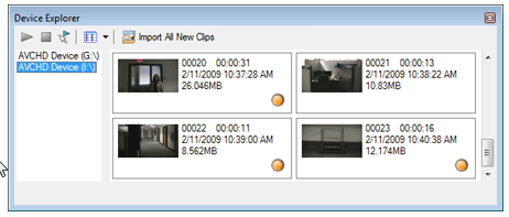

    In addition there is a "Device Explorer" utility that lets you view AVCHD or XDCAM-EX clips directly from the flash media before you import.
