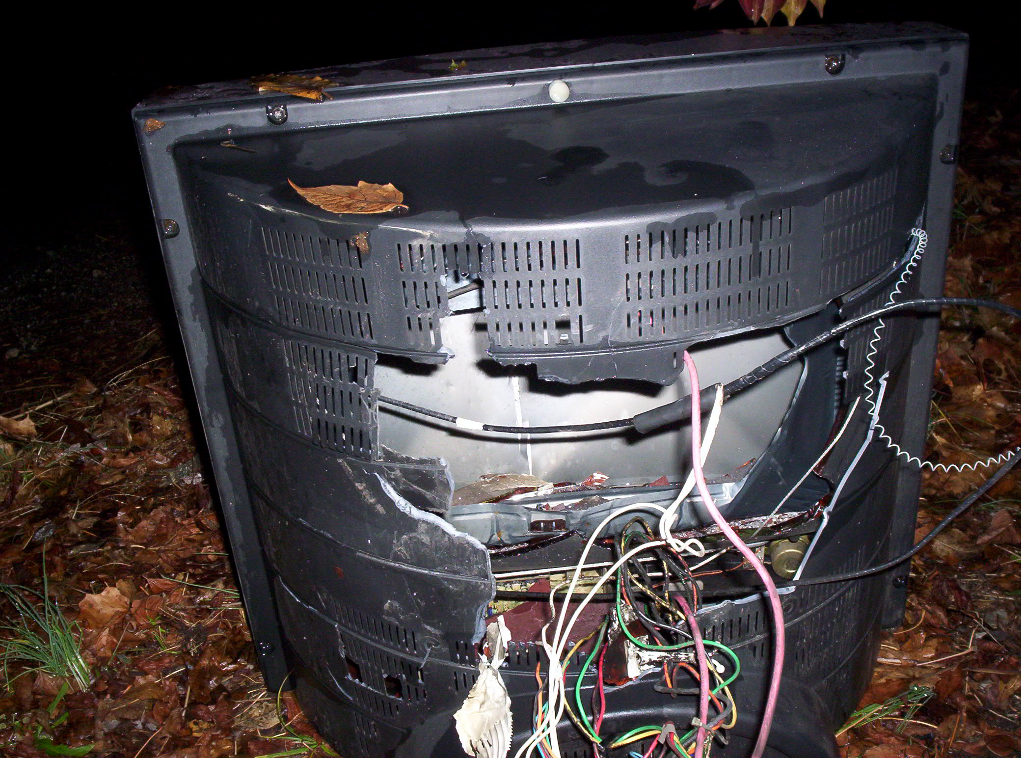

  11. Here is picture. Maybe they are taking several things.

    Well if they were stealing "copper", from that photo, they left the majority of it behind!!!
    LOL!!!
    And that's not much!!

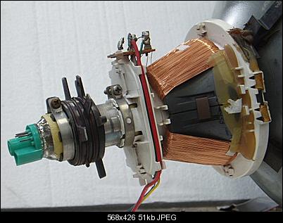

    My guess, the copper deflection coils.

    The degaussing coil by the tube face and the deflection coils around the CRT neck have some quantity of copper wire. Breaking the neck to remove the deflection coils is a possibility.
    Copper has a fair bit of market value at the moment and they break into construction projects around here all the time to steal it. I've also seen people stripping the wiring out of abandoned cars to obtain the copper. They throw it into a burn barrel to remove the plastic. The air pollution people usually ticket them for that.
