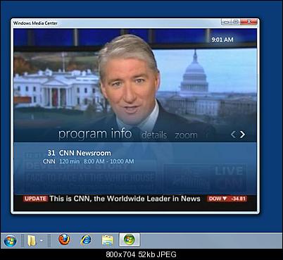

    Does it play TV in a window on the screen ala MMC? I could never get a straight answer on that (or most of the solutions I looked at, for that matter; all of the screenshots I saw had video playing full-screen).
    Yes, Windows Media Center gives the option of using a resizable window or full screen. If you want to use QAM, you will need to get Windows 7 Home Premium. Windows XP's MCE doesn't support QAM. Vista Home Premium only supports it if the TV Pack is installed, but that is only made available to manufacturers of pre-built certified Media Center PCs.

  5. Windows media definitely will run in a window in Win 7:
    That's a ATI 650 USB2 and analog cable.
