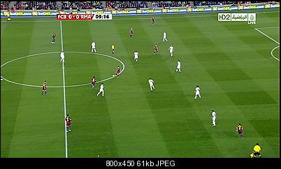

    I used this program "HDConvertToX_3.0.691.4632" to encode my Mpeg4 HD ts files recorded from my satellite receiver to MKV files using X264 codec..
    look at what i got
    this is a screenshot of the original ts file

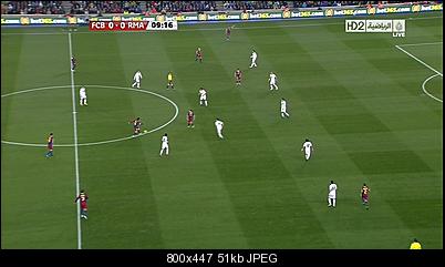

    and this is from what i get after encoding
    whats wrong iam doing and how to get better color quality??
    i tried all codec inside this program like divx and xvid and all containers avi,mkv and mp4 and the same results
    thanks in advance

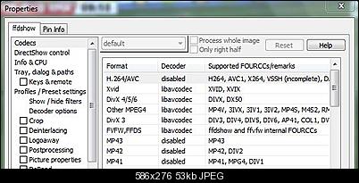

  12. well it seems its something in ffshow video filter..
    when i disable it like this
    I got the colors back..
    and the decoder that is after disabling this is Microsoft DTV-DVD video decoder..
    is this the solutin??
    and is there is any alternatives for EVR because it gives a black screen on kmplayer and they didn't fix it till now..
