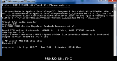

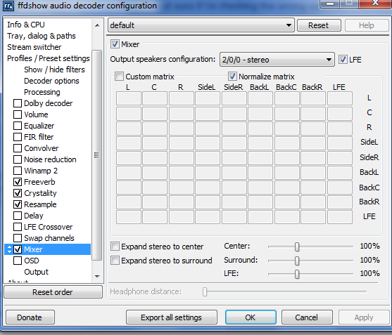

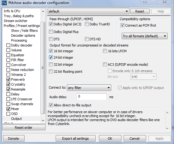

  14. Image
    [Attachment 4472 - Click to enlarge]
    [Attachment 4473 - Click to enlarge]
    is this ok? I followed one of the guides to check some of these options

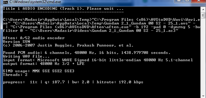

    Tried once more, coming up as 5.1-ch, it seems to be inputting it as 5.1-ch? --> Click image for larger version

  15. Madz5,
    the Aften input format is determined by your AC3 directshow decoder setup. Please make sure that ffdshow output mixer is setup as 2/0/0 with LFE off.
    To check if ffdshow is being used as AC3 decoder, you can verify with GraphEdit (go to 'File'/'Render Media File').
    Bye
