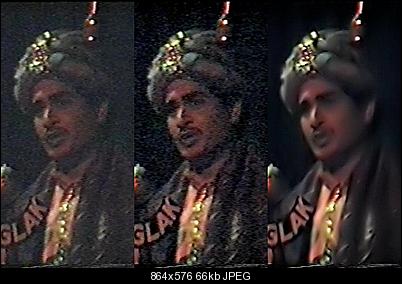

    I was using Neatvideo with the picture of your post #9, and did "auto profile" to get the noise profile.. and then used it in the video sample, then added MsuSmartSharpen "overal and borders", "MSUColorEnhancement"..

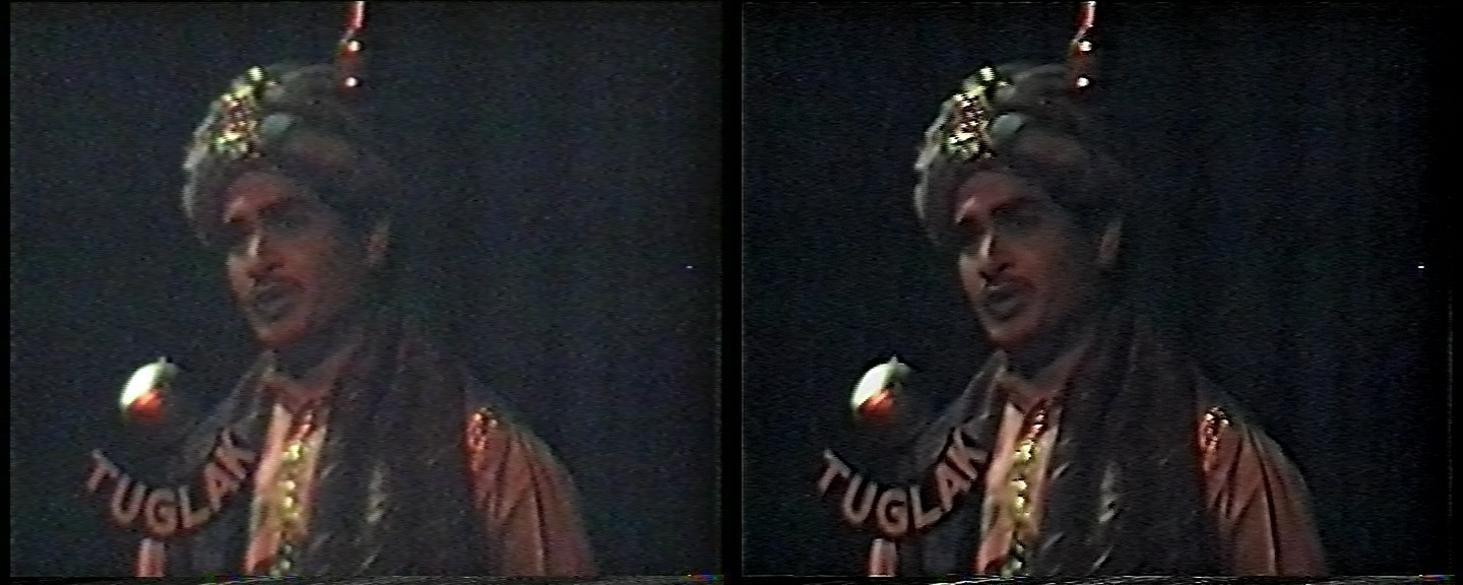

    That video doesn't have much above IRE 100 (Y=235, RGB=255) except noise:
    [Attachment 4498 - Click to enlarge]
    So there's little over-bright detail to recover.

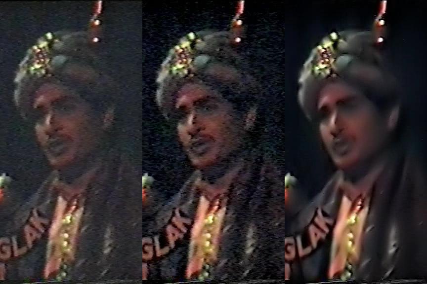

    Original, levels+gamma+saturation, levels+gamma+saturation+neat video 100%

    I think Levels was 35-255 --> 0-255, gamma 1.5. Then I boosted the saturation by about 30 percent with HSV.
  12. could you fine tune neat video a bit more ? that 3rd screenshot is a big detail killer
    or was it the fixed pattern noise that's giving problems?
  13. Originally Posted by poisondeathray View Post
    Yes, of course.
    I turned the filter up all the way to show that removing all the noise also removes all the detail that's has the same scale as the noise.
    Yes.
