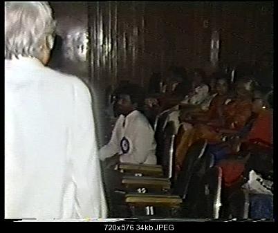

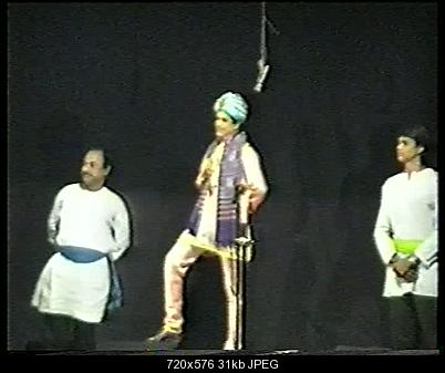

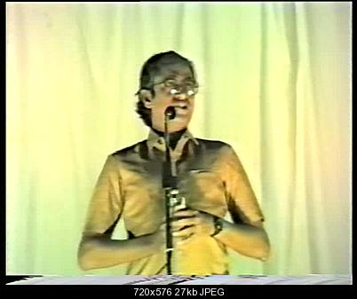

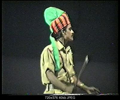

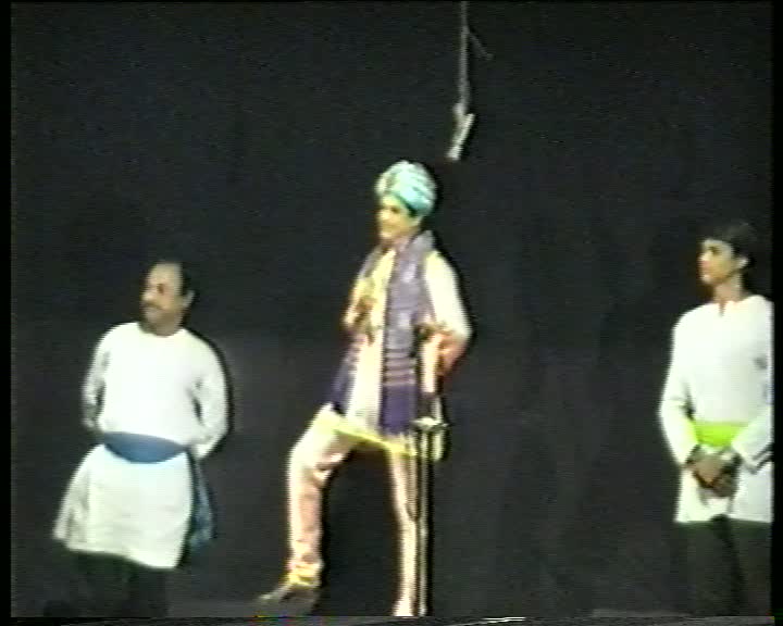

  1. Okay, I promised my uncle that I will restore the VHS Tape of a stage play in which he played the lead role 20+ years ago. I made sure he knows that restoration means only trying to remove errors, and we can only achieve reasonable quality. My set-up is below:
    JVC S-VHs VCR (Model# HR-S7600AM) with built-in TBC & 3-DNR using S-Video Cable;
    Connected to Canopus ADVC 110;
    Firewire capture of DV file into the PC.
    Softwares: Premiere Pro, VirtualDub, NeatVideo's Free version; FlaxVHS Filter
    The video is about 75 minutes. The audio is too low, which I think I will deal with separately, the focus now is only on the video part.

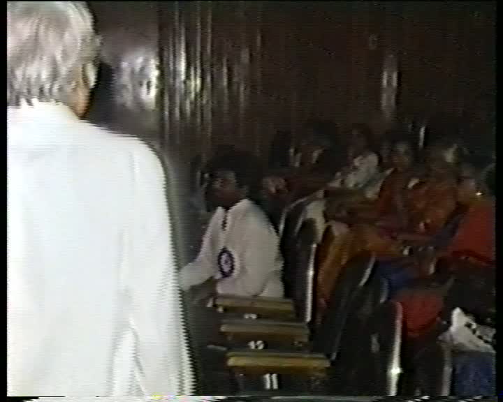

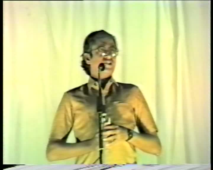

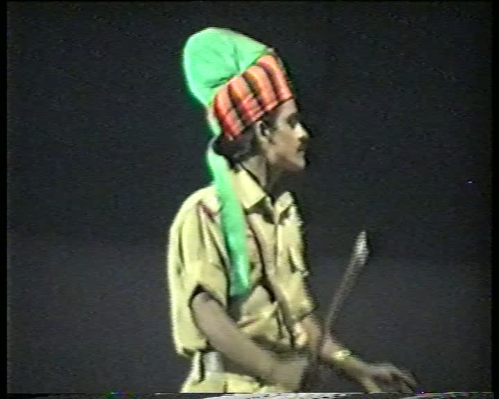

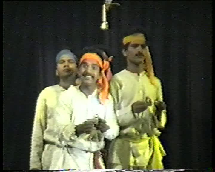

    I noticed several flaws in the video, some of which I can explain as "Chroma Noise" and "Tracking Errors", but the rest I am not really sure what to call them.
    Though I had done several VHS-DVD conversions in the past, those tapes were reasonably clean. But this one definitely needs a lot of filtering and restoration. I am new to doing any restoration.
    Your help in identifying the faults in this video (Screenshots attached) and how to fix them to the possible extent is greatly appreciated.
    I have read quite a few threads on restoration, Lordsmurf's guides...etc already, and that's how I managed to get screenshots of the frames that had problems. I need some kind of expert advise to proceed.
    The video itself is not bright enough for the eyes. I have no idea about the Camera used to record this play, and the lighting condition then.
    Screenshots below:
    The whites are too bright, and also a lot ghosting (???) around edges, colour bleeding, chroma noise...all sorts of problems.

  2. No response??? I am still trying to figure it out myself...but any help from your side is appreciated.

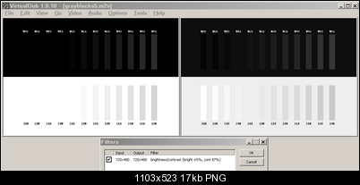

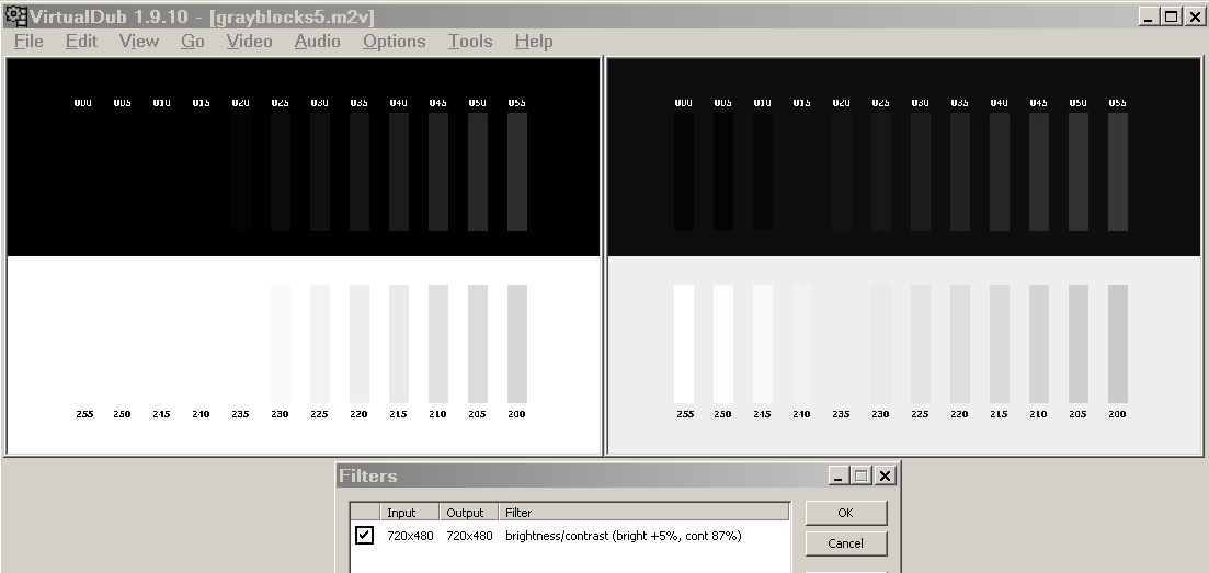

  5. You can probably tease a little more detail out of the over bright areas by decreasing the brightness before the video is converted to RGB (VirtualDub converts to RGB using the standard rec.601 matrix which will cause very bright areas of the video to peg out at RGB=255). Some filters in VirtualDub can do this -- the brightness/contrast filter for example. Apply that filter before any others. Turn the brightness down by 7 or 8 percent. Or a combination of brightness and contrast:
    Even better, use AviSynth. In my experience, VHS caps usually need to have the black level darkened too so this should work:
    ColorYUV(off_y=-20)
    If the black level is OK then one of these will work:
    ColorYUV(gain_y=-20)
    ColorYUV(cont_y=-35)
    After this levels correction you can use Alexander Nagiller's Gradation Curves for VirtualDub to make non-linear changes to the levels.

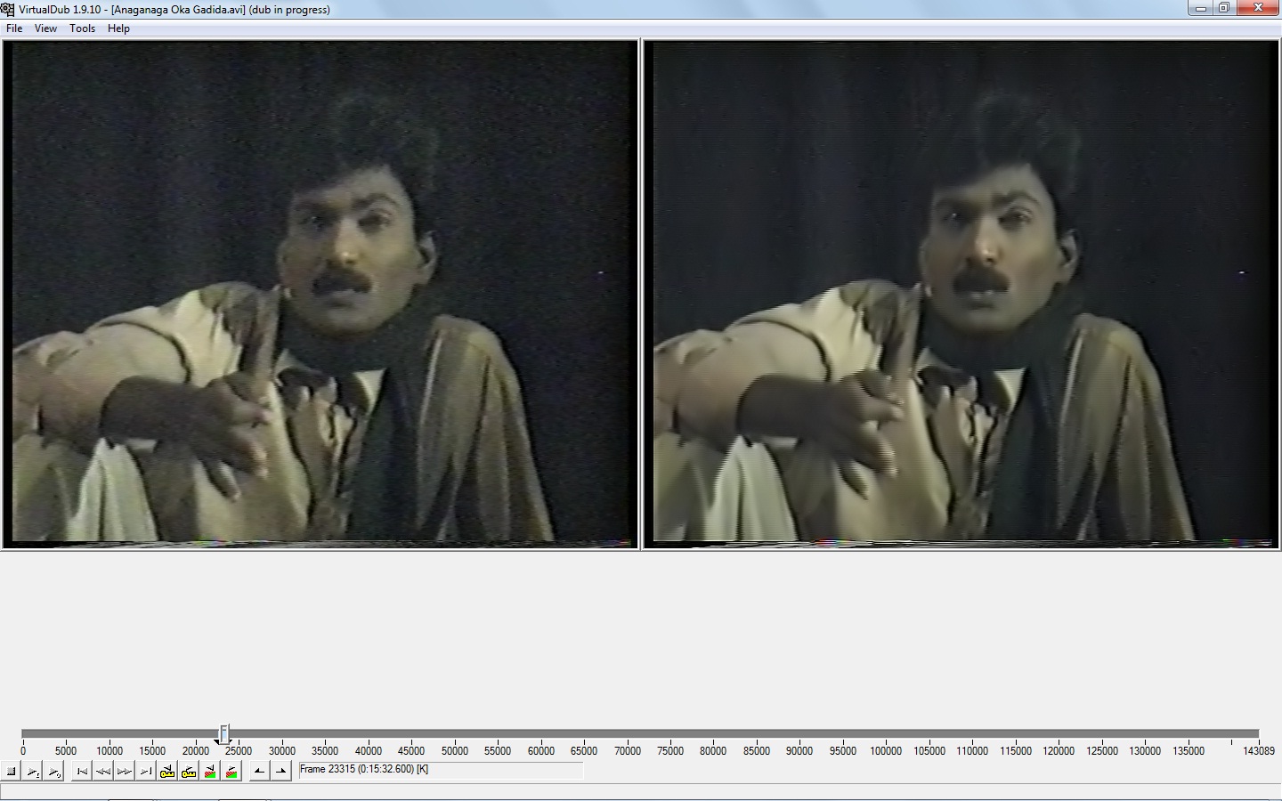

  9. Thanks everyone for the inputs.
    Applied BorderControl. It looks good for masking the bottom noise.
    Will try the following based on your suggestions: ChromaSmoother, ColorMill, Brightness/Contrast, Gradation Curves. However my level of knowledge in all filters is that I can only adjust something and see it in the preview rather than knowing the theory behind it. Avisynth is definitely not something I already know but wil give it a try.
    Will also try and search for that similar thread from sanlyn.
    I use Adbobe Premiere CS4.

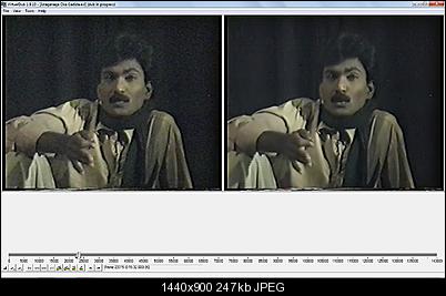

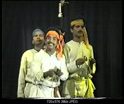

    This video has a lot of "Chroma Noise". Based on one of Lordsmurf's guides, tried filtering with "Chroma Noise Remover" with no result.
    Tried NeatVideo free version, but it is kind of creating "plastic" look. Screenshot attached.
  10. Member pirej's Avatar
    Mar 2008
    Macedonia
    You have set Neatvideo to remove "all" of the noise, and it made it blury("plastic").. try to get better noise profile in neat video, just with "auto profile option" i got 73% noise removing profile..
  11. All noise reducers result in a plastic look if turned up too high. Did you let Neat Video sample the noise from your video first? After that you adjust the noise reduction controls to your liking. It's usually best to leave some noise in the picture. Also, you may find it works better if you turn off the noise reduction at the VCR.

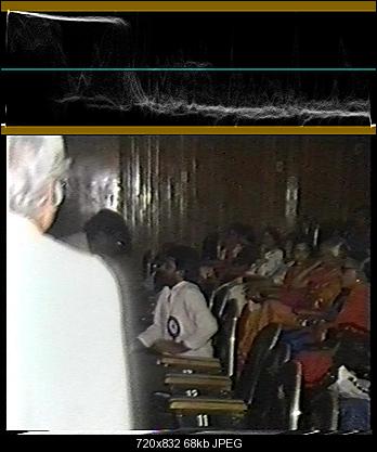

  21. That video doesn't have much above IRE 100 (Y=235, RGB=255) except noise:
    So there's little over-bright detail to recover. You might be able to use Gradation Curves in VirtualDub to tone down the over bright areas though.
