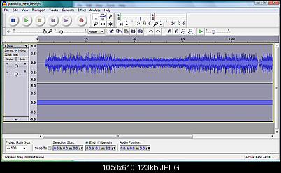

    I have a family member who bought a grand piano with a "pianodisc" player system. These players use CD's, The files on the cd's used are 44k hz samples 16 bit pcm, the left channel appears to be a standard wav (this is the channel you hear accompaniment music on), the right channel is what I think to be a proprietary digital midi format, this is the channel that works the solenoids and plays the piano.
    If you open the file in Audacity and pan all the way to the left channel the accompaniment track plays fine, if you pan all the way to the right channel, you'll just hear a high pitched tone. My goal is to preview the two tracks together, I've done some online research and it sounds like I might need something like Cakewalk Sonar to just preview the two tracks simultaneously.
    Do any of you good people have any ideas on a free or cheaper solution to simply preview these two tracks together? I can jump thru hoops and convert to almost any format for playback, this one has me beat (for now).
    I will upload a short sample of the audio file.
    sample.wav 2.54 mb
    http://www1.webng.com/robshorseplay/sample.wav (right click "file > save as")
    Thank you
Name:	audacity image.jpg

    I think I understand now.
    Play the wav file with VLC media player.
    Choose:-
    Audio > Audio Channels > Left
    That will play only the piano without the tone.

    Anyway, looking at the sample file, it appears to me that the right channel is using some sort of tone modulated encoding of midi data (which as you may know is digital in form). To be able to play this (or extract the original midi data) without the PianoDisc hardware, you would need to know the form of this encoding and some fairly sophisticated wave analysis software.
    A brief Google search turned up a midi to PianoCD conversion tool, but nothing to go in the opposite direction. However, I did read that PianoDisc players (maybe just some) have direct audio inputs that will decode the midi-as-audio track, so maybe you don't actually need a physical CD.

    As an experiment you could save the right channel only and then rename the suffix from wav to mid and then see it that track will open in a midi sequencer program like Cakewalk or SONAR etc. I doubt it somehow as the data track (and that is what it is) is probably a proprietary version of the midi standard. A midi file is just a series of instructions like a punched tape in a pianola and does not contain any audio just the instructions to tell your computers wave table or synth which instruments to play, for how long and how loud etc..
    The data track would contain information about which notes come out of the left and right speakers in the piano (I am assuming it has a left and right speaker) Often the spit is middle C or an octave above. But you can spread each note anywhere between in the data.
    There are a few midi utilities to convert a midi track to wav or even text but in this case I think the midi data has been used to modulate an audio frequency carrier that can then be used as the right channel of a stereo wave pair. On playback the piano demodulates the right channel to extract the original midi data.

    Ok, looks like the solution is going to be to create the wav file with one track for accomp. the other the digital signal, which I've found out is proprietary to the pianodisc player. There are apparently RCA audio in jacks on the back of the player, take a mini stereo to rca cable and play from my laptop to the pianodisc system. Wish I knew it had those jacks before all the time and thought... <sigh>
