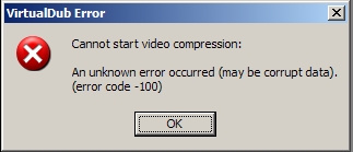

    First I tried to use virtualdub in video full processing mode, xvid target quantizer 4, and audio direct stream copy. See the error in the attached. Of course I added the resize filter before run.

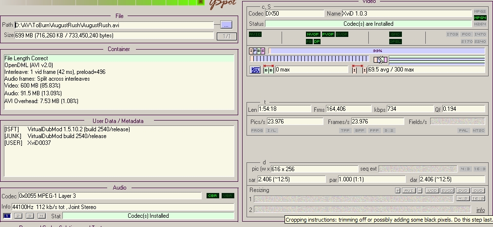

    What is strange is that AGK reports source as DivX while GSpot says the source is XVid!
    Also strange is the fact that AGK got stuck on audio, and virtualDub got stuck on video.
    Both DivX and XVid are installed in the system.

    Yes . If you look at the header of the file in the HEX editor, the so-called "video codec FOURCC handler" is "xvid" , while the
    "video format FOURCC code" is "DX50". Both can be overridden in Virtualdubs extended open dialog - although as I mentioned,
    I opened it without issue as-is.

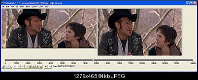

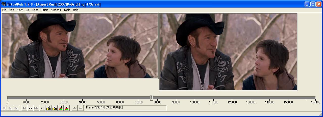

  14. I guess the matter is subjective.
    Anyway, I thought I 'd give it a 2nd try, so I loaded it on VDub, this time using DivX codec. In code configuring I selected Home Theater preset 3 and overidden source AR to 640x360. The process took 20 minutes.
    Is it possible to maintain picture quality when resizing? If yes, what settings should I use?
    See picture below.

    Don't screw with the aspect ratio when resizing. Crop to 1.778 : 1 (16:9) first, the resize after that if necessary. Note : if you are cropping files that are not original source (your own DVDs) then chances are they have already been cropped (bars removed) and resized down. When you crop them further, they may become quite small. Resizing them back up will only degrade picture quality further. That is the price you pay. If you are using your own DVDs as source material, start by cropping off the bars (leaving a small amount for overscan is usually a good idea), then crop the edges off to get to 1.778 : 1, and encode at whatever resolution you are left with. Trying to resize up will only hurt you.

  16. Re-encoding with a lossy codec will result in quality loss too. And finally, the bigger image on screen will make all those defects and low resolution more visible.

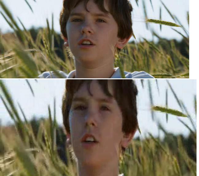

    Here's what I came up with, bit of a compromise. I cropped 36 from the left and right
    then resized to 544/304. SO you lose less at the edges and the stretch doesn't look so ridicuous:
