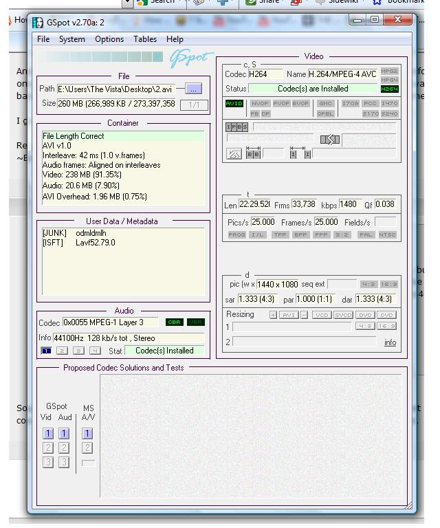

    Apologies for a late reply, I've been away from home during my absence.
    Regarding my issue, erm, I have downloaded the dubiously named GSpot lol, but my lack of knowledge on this subject has left me struggling =/
    I have uploaded a picture to see if you can hopefully/possibly take a look and help me out further..?
    Many regards,
    ~Encrtia.

  7. Is it interlaced or progressive ?
    Use mediainfo view=> text
    Gspot reports 1440x1080 , where do you get 720 and 640 from ?
    If it's progressive , you can demux with mkvextract and use avc2avi to re-wrap it into avi container with no quality loss. You can use avimux-gui to add in audio or import separately. You might have to convert to wav first (e.g. audacity, foobar, eac3to etc...) .It should import into premiere if you have ffdshow installed and avc enabled in the vfw configuration

    Gspot reports '1440x1080' , where do you get 720 and 640 from ?
    Ah, Ok. I meant that when I converted the original file of 1440x1080 by a now uninstalled program (can't recall the name now =/) it destroyed the resolution by making it go down to 640xXXX .
    Is it interlaced or progressive ??
    Sadly, my knowledge on this is very limited.. but to save just saying "huh?" I've done some research, and having to make a guess, I'd say Progressive. The clip being used is an Animated Cartoon clip, and since you can see the movement frame by frame when slow enough, I think (as someone on this forum said, "you have to see, you can't really figure it out with any software") it's Progessive.
