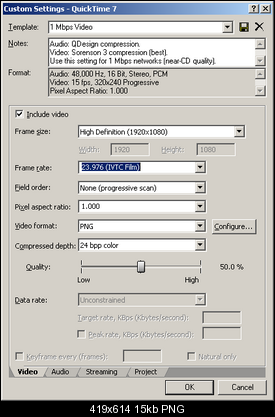

    I believe budwzr said to copy and paste your clips into a new Video track and then use "Track Motion" to reverse all clips on that track.........
    You could (if you want) export the clips with Alpha Channel if you export via Quicktime7 and use 32-bit PNG as export format. You'll end up with an .mov (lossless) that you can then import into Vegas. You'll need to go into the clip properties and tell it to use the alpha channel to make it transparent on the timeline. Use "Strait Unmatted".

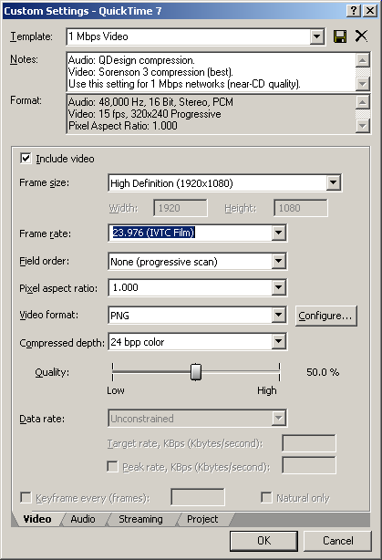

  10. AHA! Awesome the PNG format is what what i needed! Hmm seems that i don't have the format installed though:
    Is there any way to get it?

    Install the latest version of Quicktime Alternative. Get it in the tools section on this site.
    It should then look something like this after you click "Advanced" button:

  13. In racer-x 's screenshot it should say 32bpp under compressed depth , not 24 ( = 32 bits per pixel, meaning 8 red, 8 green, 8 blue, 8 alpha)

    Ya, my bad. I was in a hurry and forgot to set Compression Dept to 32bpp for the screenshot..........
    I use this method all the time to create my animated lower 3rds and such. It works well.
