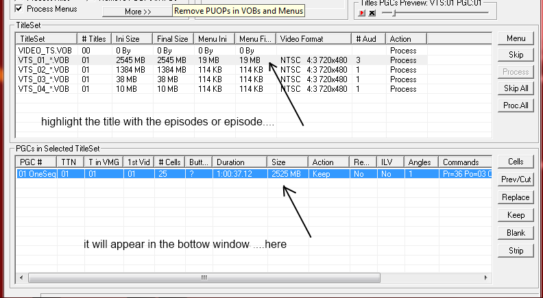

  9. Yeah, open the DVD in VobBlanker. Highlight an episode so it appears in the bottom window (or a VTS that might contain all the episodes). Highlight the episode in the bottom window and hit 'Cells' to the right. In the new screen highlight and 'Blank' the cells (chapters) you want to remove. You can also 'Prev(iew)/Cut' to make sure you're blanking the right ones. When all done hit 'Apply' and go to the next episode. When all done with all the episodes process the DVD. In the guide below, the cell blanking section is at the bottom:
    http://download.videohelp.com/jsoto/guides/VobBlanker/blanking/index.php

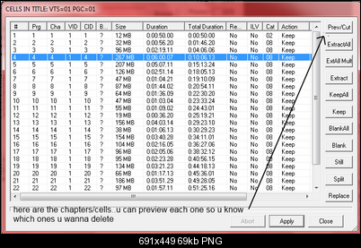

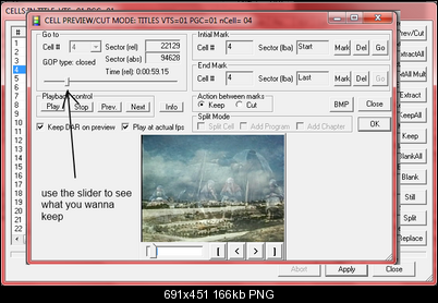

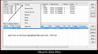

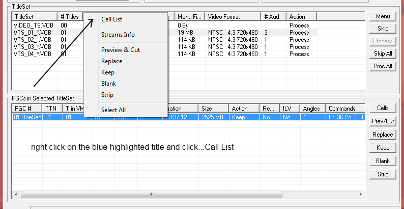

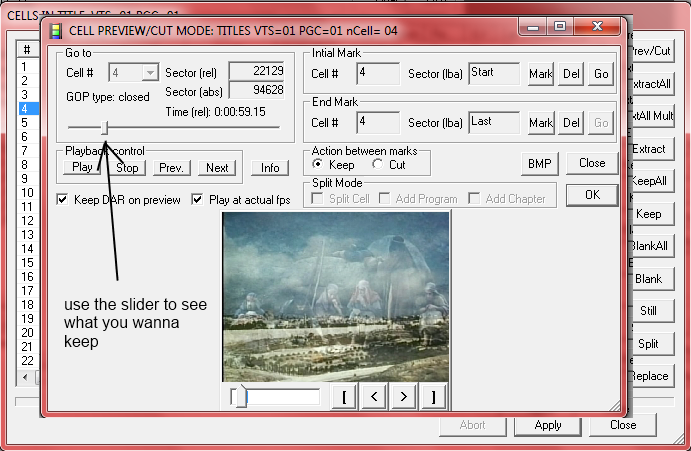

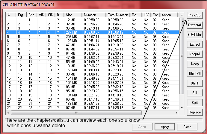

    Nov 2005
    1.open VobBlanker and browse to the dvd folder and click on the "ifo"
    2.
    3.
    4.
    5.
    click on Close...Then Apply
    Then Process
    one of a handful of must have tools for dvd maintenance.

    not even close. It does what pgcedit(PGCe has more options but the basics are covered w/ vobblanker) can do...dvd decrypter...dvdfab(w/ the exception of on the fly decrypting and shrinking)...its just takes out what u don't want...and what u want to do...
    I want to remove chapter two (opening theme) and the last chapter (credits) on each disc,
    Then burn a disc with only two episodes on each disc.
    would take all of 5 minutes or less...and most of that time would be the ripping to the drive
    in the window where it shows the cells/chapters..u would click on the first cell/chapter and click on "blank"..then click on the last one, then click on "blank"...click apply and process it
