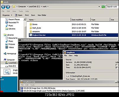

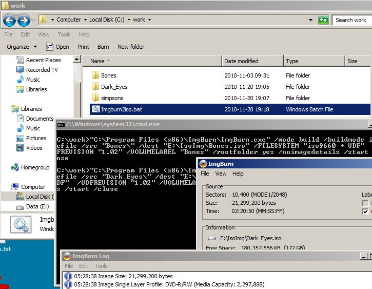

    Using ImgBurn and a batch file to create .iso image files from a standard DVD folder:
    A folder named C:\Work contains the batch file and the DVD folders (each dvd folder in turn contains a folder named VIDEO_TS).
    The video files are no more than would fit on a standard disk (~4.3GB).
    The destination for the iso files is E:\IsoImg
    Change the following in ImgBurn [Tools > Settings > Build, page 1 set the box to Check 'Close Program']
    This is the bat file (change paths as required).
    @for /d %%i in (*.*) do "C:\Program Files (x86)\ImgBurn\ImgBurn.exe" /mode build /buildmode imagefile
    /src "%%i\" /dest "E:\IsoImg\%%i.iso" /FILESYSTEM "iso9660 + UDF" /UDFREVISION "1.02" /VOLUMELABEL "%%i"
    /rootfolder yes /noimagedetails /start /close

    Using Imgburn with the default settings (and the Check 'Close Program' option selected), it should work.
    Even if the VIDEO_TS folder is buried in multiple folders, it will locate it.
