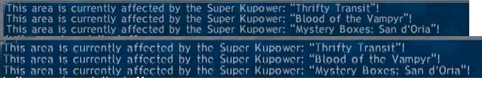

    The upper picture is the raw fraps footage, beneath was encoded in Adobe Premiere H.264 Blu-ray
    (settings for the lower image)
    Output: NTSC, 1920x1080, 29.97 FPS Upper Dolby Digital, 192 kbps, 48 kHz VBR, 1 pass, Target 25.00, Max 30.00 Mbps
    Source: Clip, Proxy Sequence 1920x1080 (1.0), 29.97 fps, Progressive
    Hope this helps some

  9. It looks like Adobe is interpreting the footage as interlaced . Either you didn't set it up correctly, or your playback software is deinterlacing it
    Try multiavchd
    What FPS is your fraps footage in ? You're in the UK correct ?

    1080 output for blu-ray is interlaced at 30fps. any lettering will always look crappy as they are written to the screen in pieces. if you are concerned about text, i would try 1280x720 60p for blu-ray.
