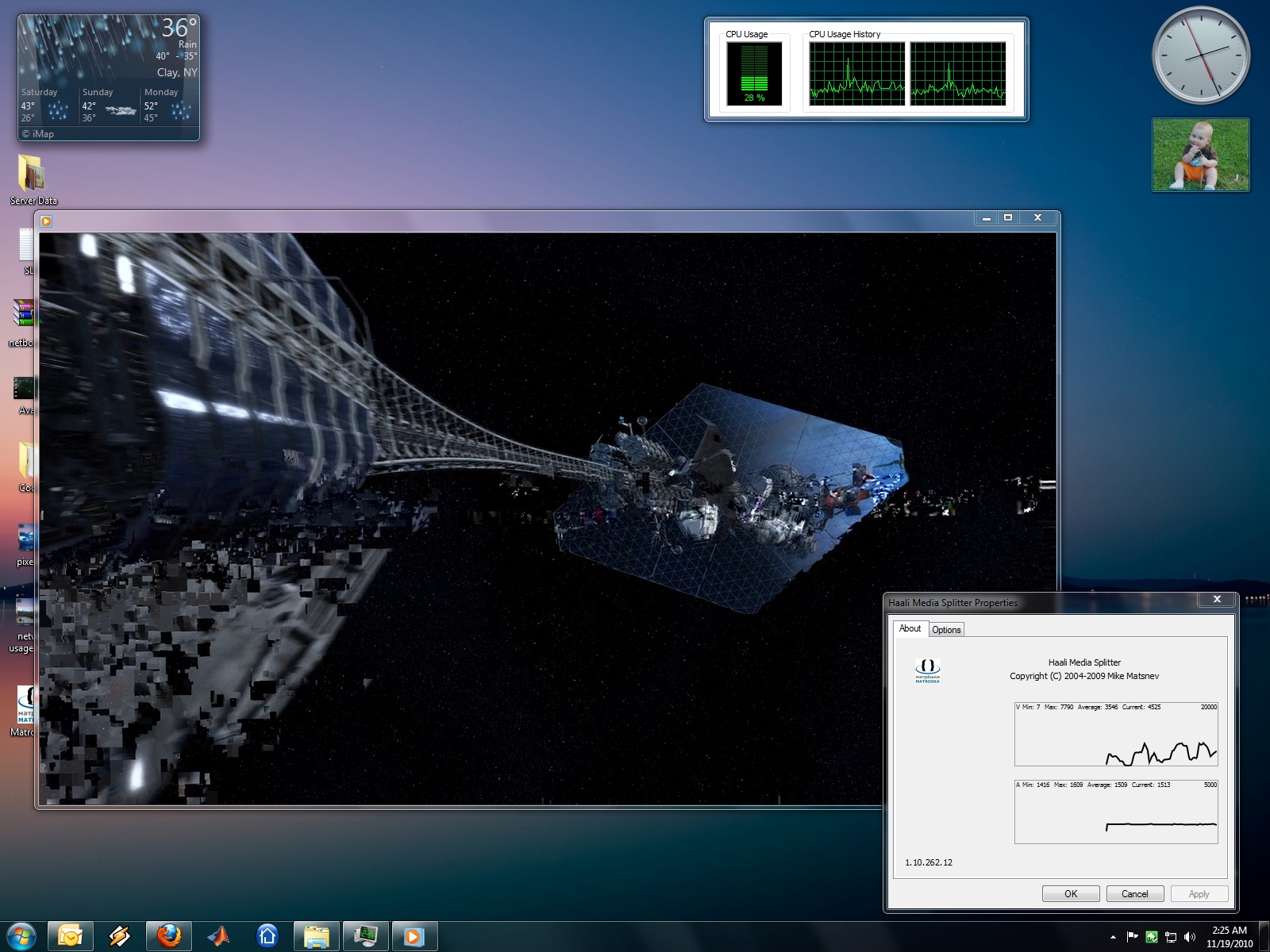

    Attached are some screenshots of one of my mkv files (Avatar). Haali media splitter shows a graph that peaks when the pixelation is particularly bad. CPU usage hovered around 20% with occasional peaks ~40%. This is my workstation PC that uses a dual core AMD 3GHz processor and 2Gb of memory. I'll repost the same shots using MPC-HC.

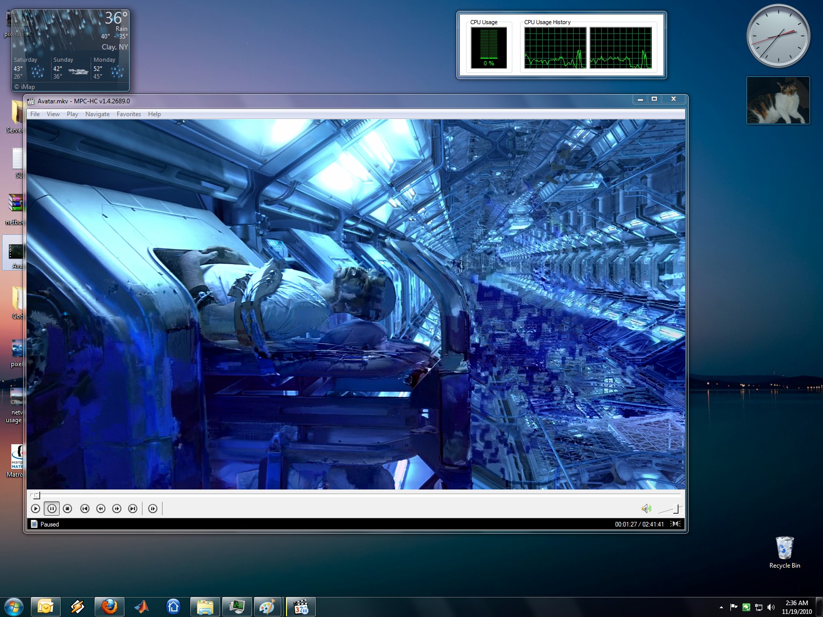

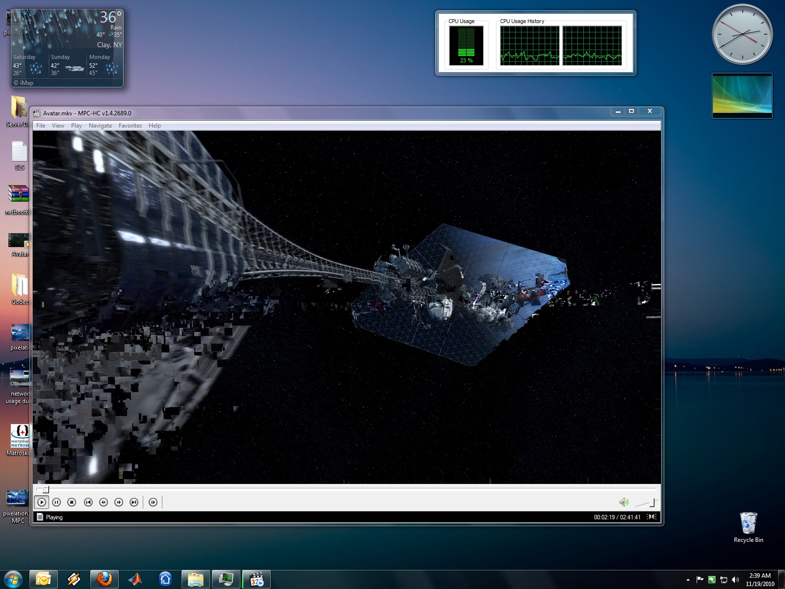

    Ok, now here's (roughly) the same scenes captured from MPC-HC. CPU usage seems about the same. I noticed that Haali did not load this time.. not needed for MPC?

  5. Member AlanHK's Avatar
    Apr 2006
    Hong Kong
    It has a splitter built in.

    Thanks for all your responses. I ran a test using VLC, but I'm seeing the same pixelation. The problems appears independent of player. I continued watching the movie while keeping am eye on the mysterious Haali media splitter graph window. As the movie plays, that graph really levels out and the pixelation seems to become less frequent.
    I really need to know what that graph is telling me. Anybody have any ideas?

  7. Originally Posted by ajkrishock View Post
    It's a bitrate graph for audio & video. Big action scenes will get more bitrate and show a peak
    If you're playing this over a network, there is a tiny tiny chance that it's exceeding the bandwith and causing the pixellation (very unlikely, unless you have concurrent traffic)
    If you play locally on a HDD and on other computers, this rules out bandwidth as the issue
    Try playing on a friends' setup, or reverting to older drivers - it might be the newest drivers are causing the issue
