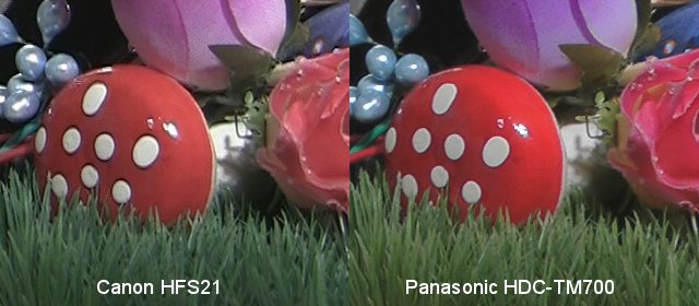

    Check out the comparison of the HFS21 vs TM700 which shows an interesting difference in the colour resolution:
    The HFS21 is less defined on the toadstool compared to the TM700.
    Although there are some anomalies in their tests:
    - The HFS21 is in 'interlaced' mode, the TM700 has been set to 'progressive' which may affect the resolution
    - They've used the same test image for the Canon HFS20/HFS200/HFS21 and just renamed it
