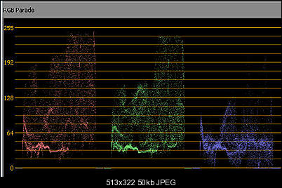

    There's not enough range in the blue channel.

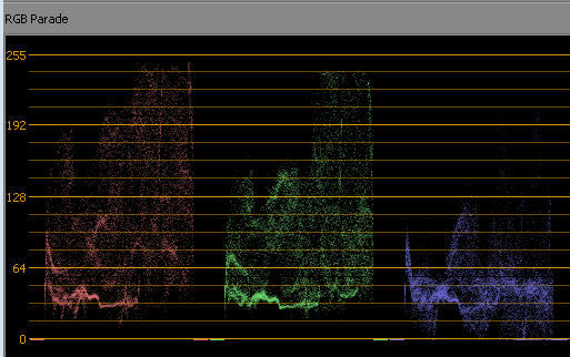

  7. budwzr, I noticed that too. I had some success correcting itn in Vegas though. Used a white balance and a color corrector to punch the blue. I don't usually mess with the gain too much because I don't trust my monitor and PC monitors are generally darker than TVs. I may bump the brightness up a pinch though.

    Blue information is missing above 128 and therefore the complementary colors are showing as strange hues only in that missing range between 128-255.
    AFAIK, the other two color channels are intact, so I'm trying to figure how to combine them and substitute blue into the affected range and see if that will composite as an "add".
  9. My method of simply boosting the blue channel is crude at best. If you come up with something effective I would love to hear about it. Sometimes if I have a really weak color I'll lower the strength in the other two channnels to balance the overall color saturation. This obviously dims the over all color but can help. I have some footage with missing channels I will have to convert to B&W. This Sample footage is recoverable though, I think.
  10. You can make any non-linear adjustments you want to the color primaries using Gradation Curves in VirtualDub.
