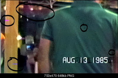

  4. You really need to click on the Attachment 5936 link to see the big image. In the green shirt and on the man's arms you will see lots of blue and yellow "chroma noise" splotches on the left and their removal on the right.
  5. Originally Posted by magillagorilla View Post
    I get this:
    Invalid Attachment specified. If you followed a valid link, please notify the administrator
    The image/link in post #62 works.
    Is there and AVISynth filter for this type of noise?
    Yes. CNR2() and others.

    I don't know why my picture became a link, the forum did it. So you would recommend CNR2(), I'll try it. There is other noise I can't seem to get rid of in VDUB.
    The hard chroma noise on that poll on the left, I think are dropouts and maybe can't be fixed. The pink haze at the top is still there and there are some hard black dots in the image I thought the median filter would lighten but didn't. I don't expect miracles from my footage because it's in really bad condition. When I see how well the chroma noise removal in VDUB works, I just wonder if I can push it a bit further and get even better results.
    Keep in mind that this is one frame of hours of video chalk full of this kind of noise. I chose this frame to show because it runs about in the middle of my gambet of issues. I also prefer to keep noise upposed to smudging the footage and heavily blurring it, if that is the solution.
  7. If those pink and blue spots are transient (appear in those postions in only one frame) something like RemoveDirt() should help.

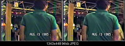

    FWIW, I did try to see if anything was doable, and I came up with not much as evidenced here, using Vegas.
    http://www.youtube.com/watch?v=FcXe9bHYwkc

    Neat Video can be plugged in to Vegas, but your issue is related to missing pixels in one or more of the RGB channels, not noise.
    This kind of thing is not my forte, but I'm intrigued by the "undoable", and it's kind of bugging me so maybe my brain will let me know something later.
    I'm thinking along the line of building an HSL mask that targets the offending hues and then compositing the missing channel.

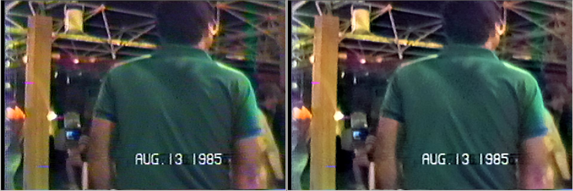

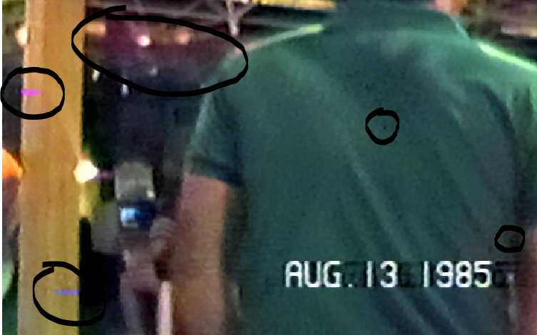

  18. Budwze, I had the same kind of idea. The dropouts are very specific bright pink/purple and should be easy for a selection parameter to identify. Unfortunately, I have no idea on how to approach such a thing. I ran another test last night:
    AviSynth (Yadifmod)>VirtualDub(Camcorder noise removal>Neat Video)>Vegas(Black Mat>White Balance)>.MP4
    It looks better than any previous attempt. The dropouts are smoothed out a bit. Lots of the bad chroma grain is gone. Still looking for other options. I literally have 20-25 hours of footage to process and I am exploring many options before dumping a huge ammount of time in to it.
  19. What is the distribution of the pink/purple "dropouts" ? Are they random and appear only on single frames ? If so then jagabo suggested removedirt - that should take care of it . There are related functions like removedirtmc, which are more selective
    To narrow in on a specific color you can use secondary color correction in vegas. There are dozens of tutorials on youtube and related sites. This is the same idea like in photoshop, where you change the color of somebody's shirt. I'm sure you get the idea.... The problem is you have to replace it with "something" - like some other color. This will be a bit of manual work because presumably those artifacts aren't always over an orange pillar - and even on that single frame you have 2 different hues of "orange". So this will be quite a bit of tedious work . It doesn't "automatically fix" it or fill it with surrounding pixels or related information. RemoveDirt and related functions do fill the gap
