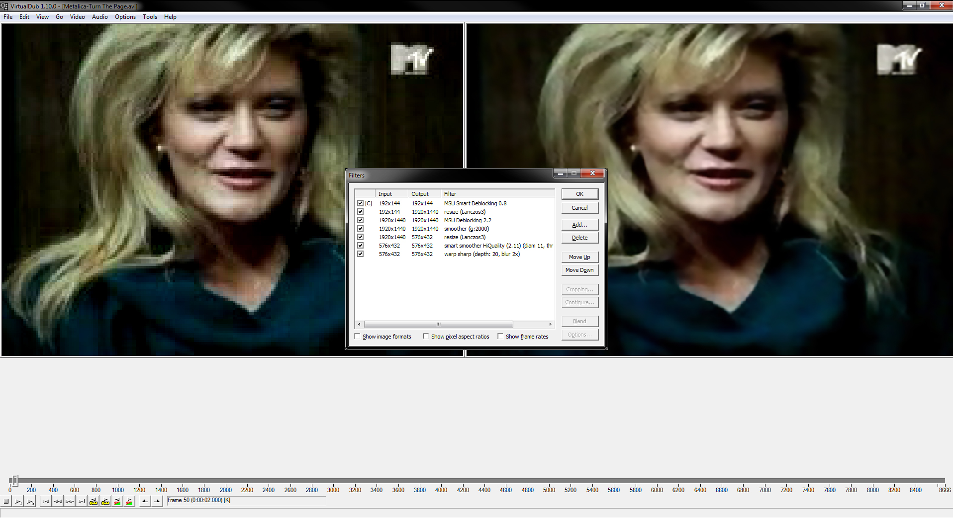

    Here is a screenshot from the Virtualdub forums where a guy used different filters to make a low resolution video look a lot better.
    He states in the thread to remove excessive noise, add multiple smoother 40 to increase detail, increasing warp sharp could add denoising,
    could also add msu cartoon restore.
    http://forums.virtualdub.org/index.php?act=ST&f=5&t=19620&
