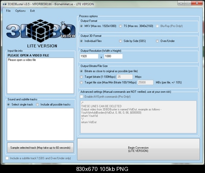

  6. I'm a MEGA Super Moderator Baldrick's Avatar
    I added 3dbdbuster to our tools list,

    The 3dbdbuster picture seems to indicate you can only add a new subtitle track on SBS and Over/Under mode. So I guess in order to add a new subtitle track while keeping all original 3DBD structure, may require this tool to evolve, or perhaps a new tool to become available !!
