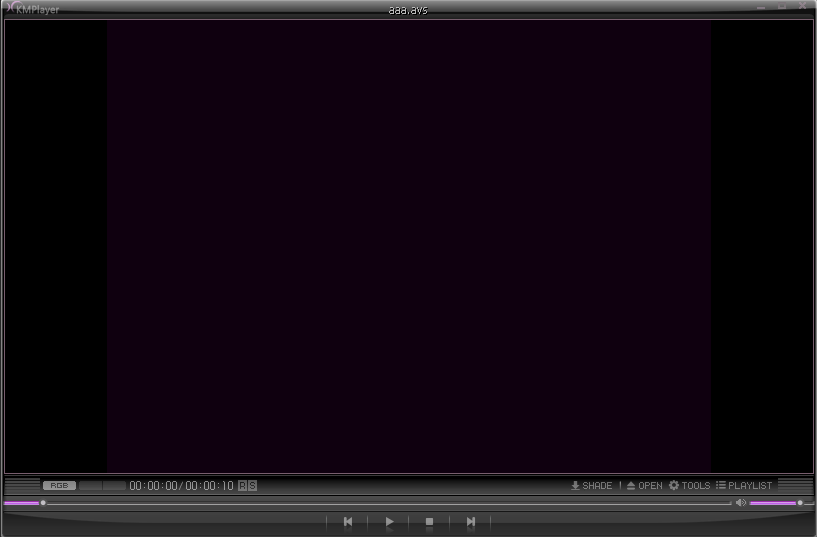

    what do you mean with lifted upwards? here´s one example:

    i loaded ur given script and get the following error:
    Script error:Subtitle does not have a named argument "align"
