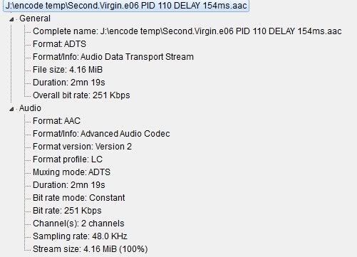

  3. what kind of audio ? use mediainfo
    how are you inputing the audio ? directly or through avs script ? in a container or elementary audio ?
    make sure you do not have any spaces or non english characters in the filenames
    Dec 2007
    Hong Kong
    thanks for the answer~
    this is the mediainfo information
    I inputted my audio directly through the megui audio inputting box
    and the audio is extract from the TS stream

    Try zeroing out the delay (the number written in the name will be entered if you use the audio directly)
    Exception message: Script error: Invalid arguments to function "DelayAudio"

    thanks poisondeathray,you are right, it is the path's problem, the "..../encode temp/..., when I correct it as encode_temp, it works flawlessly, thanks for your advice!
