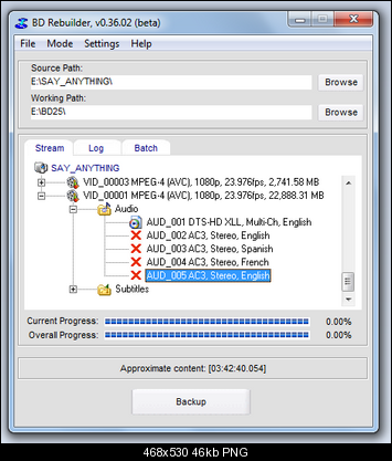

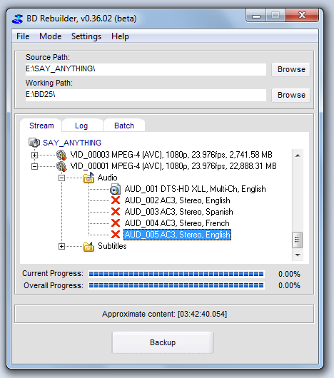

  4. bdrb can handle seamless branching disks. Just deselect unwanted stuff on the branch out.
    When you run bdrb, bdrb will automatically deselect you're unwanted stuff for all m2ts files associated with original.

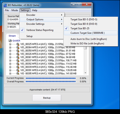

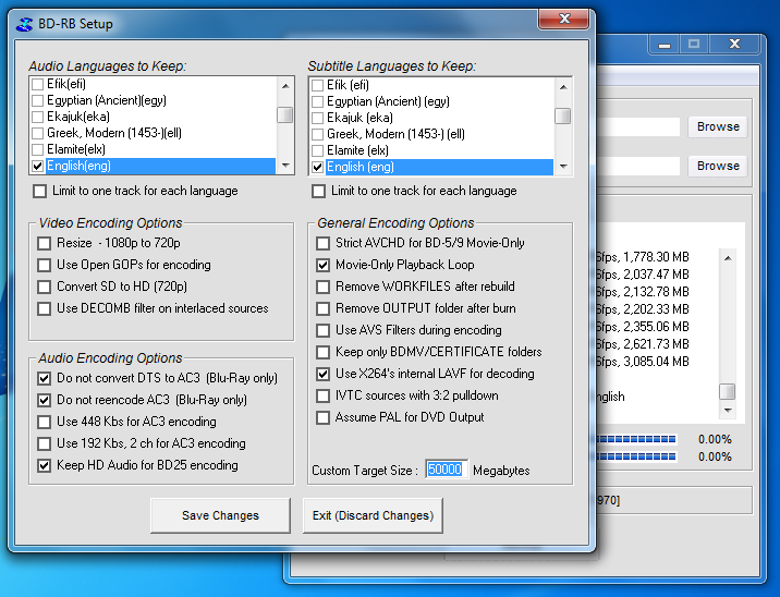

    To select BD-50, go to Settings, then Setup, and put 50,000 in the Custom Target Size box.

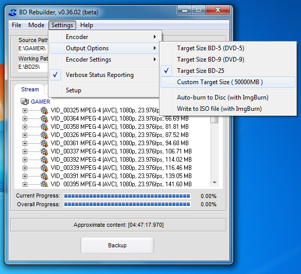

    Then make sure you select Custom Target Size in Output Options.
