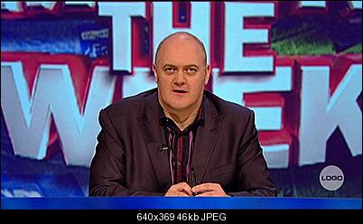

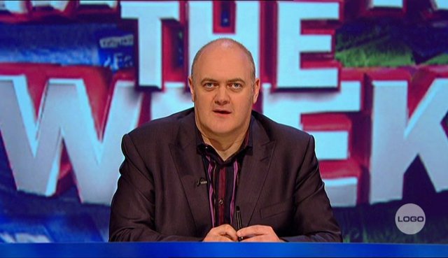

    mplayer/mencoder might also be an option, (it's available for Windows). I've just followed this:
    http://wiki.showmedo.com/index.php/Video_editing_Ubuntu#Logo
    and managed to produce this:
