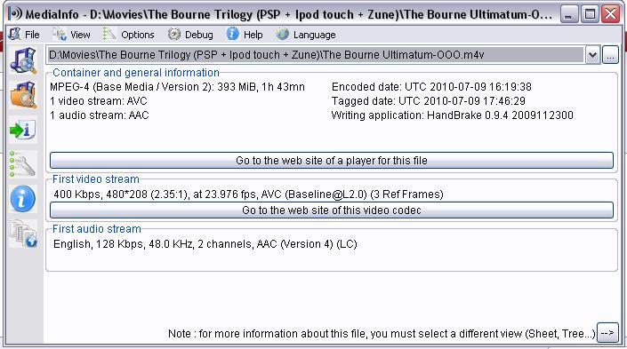

  3. Here is the snap of the details of the file type whose volume I need increased.
    I will try YamB.
    Thanks for the Suggestions.
