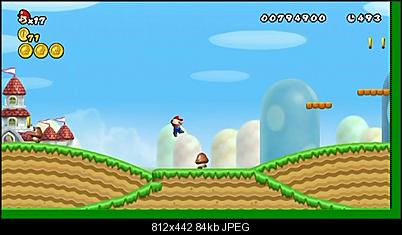

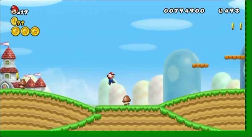

  2. I managed to fix the above problem, I think, but now I've encountered another when cropping out black bars. The following picture is the output from stretching the input to 16:9 and cropping out black borders. Any ideas how to remove the green bars now? ThanksClick image for larger version
  3. possibly a non mod-16 resolution issue
    make sure your dimensions are divisible by 16 , because some decoders have issues otherwise . Either crop or resize
    ffmpeg doesn't handle transport streams very well natively ; you could use avisynth and ffmpeg or another tool
