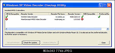

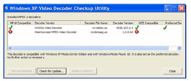

    I'm not sure what "muxed inside a proprietary wrapper" means. Is dvr-ms an mpeg2? If so, has mine gotten corrupted? If so, how do I fix it so the fast forward and reverse work normally.
    When I did decheck.exe to check for installed codecs I got the following:
Name:	DecCheck codec 01.jpg
    [IMG]file:///C:/DOCUME%7E1/HP_ADM%7E1/LOCALS%7E1/Temp/msohtml1/01/clip_image002.jpg[/IMG]It shows the only compatible codec is the nvideo codec. Is deccheck.exe not showing all the applicable codecs?
    Is it possible my fast forward / reverse problem has nothing to do with codecs?
    What would cause a system that worked very well as a DVR for half a decade to develop this problem all of a sudden?
    Thanks for the info.

  5. Member edDV's Avatar
    Mar 2004
    Northern California, USA
    I have MCE running in Vista and Win7. Your problem seems specific to XP MCE. I suspect the nVidia codec install has taken priority over Windows DirectShow codecs. Best people to ask are at http://thegreenbutton.com/files/default.aspx.
    Here is a overview description of the DVR-MS format. It is VBR MPeg2 + MP2 or AC3 audio in a proprietary ASF wrapper that contains all the DVR metadata for operation within MCE. http://en.wikipedia.org/wiki/DVR-MS
