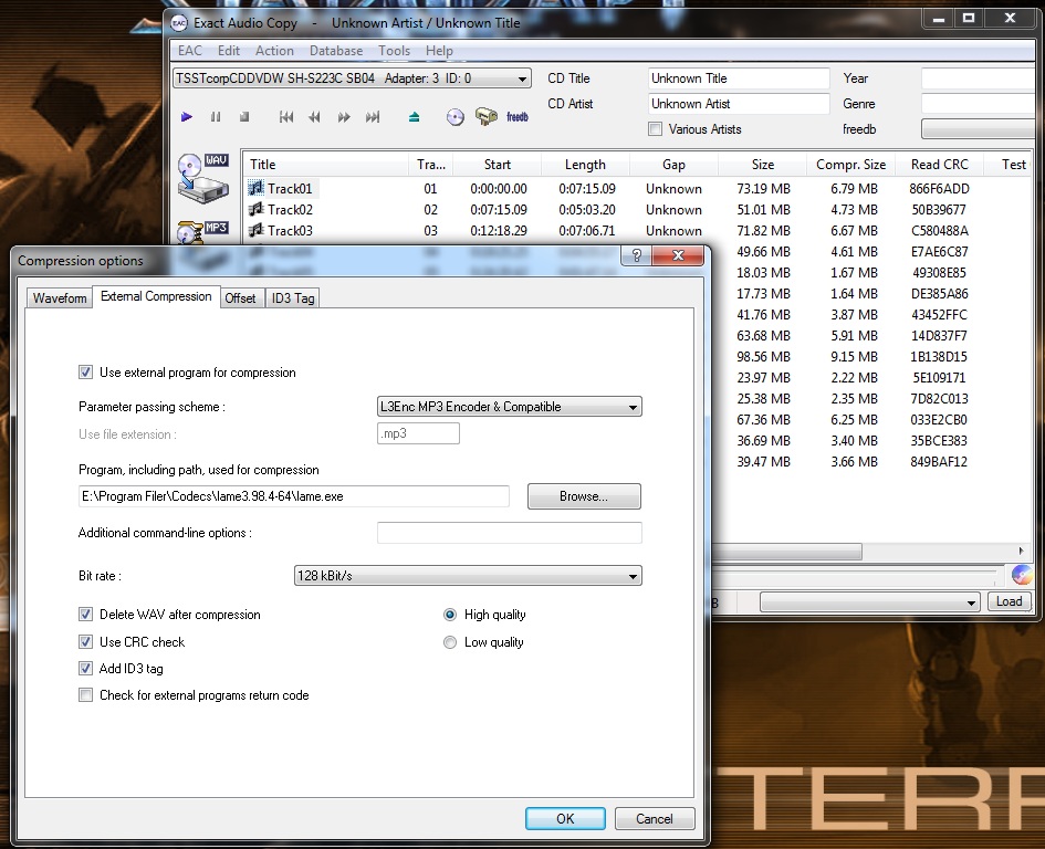

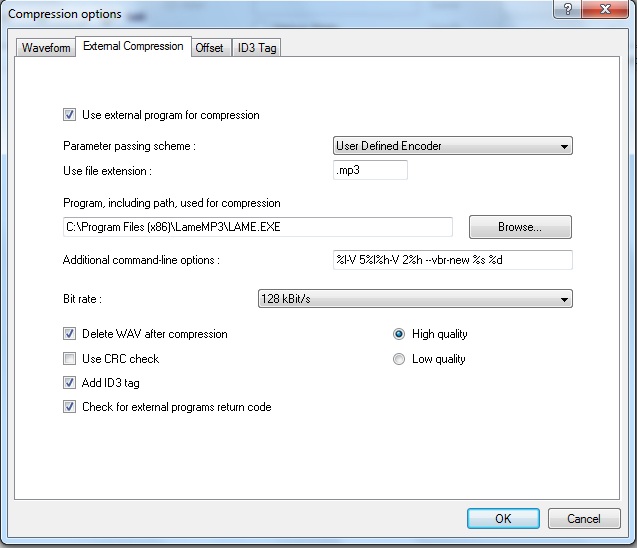

    the attachment picture is the problem, i cant longer find any way to compress the
    output to a Mp3...i dont wanna be forced on a large wav file
    have checked settings..and i decided the only thing i can do is to sett a external compression
    (i dont know why i do this though, but my memory of this program is that it required LAME pointed
    to the settings, but that time it forced me to locate the lame directory to extract MP3, now it doesnt ask
    for it , and now it extract...but its only wav even though i sett mp3 i think?
    windows 7 64-bit, still hade this OS when it worked to create Mp3 some month ago, so
    we can forget about the OS part of this

    In the second picture....you are asking EAC to use L3Enc to do the encoding....not LAME.

    Yeah, I think in the second picture you need to change the 'Parameter passing scheme:' option to 'User Defined Encoder' and in the 'Additional command-line options:' box put
    -V 2 %s %d
    depending on the quality/bitrate you want.

    Yep, just set the options correctly.
    You can't have it set to encode with one program then have it pointed to a completely different program.

  8. Originally Posted by hech54 View Post
    I see my mistake now, works fine now thanks
