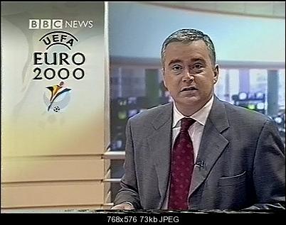

    With mplayer, the first image is de-interlaced with 'onefield' (poor), no noise reduction, no sharpening:

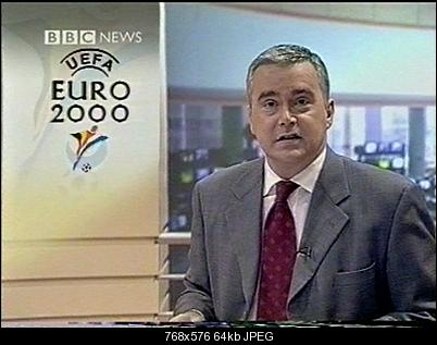

    Also with mplayer, the second uses yadif, high quality noise reduction (hqdn3d), and sharpening:

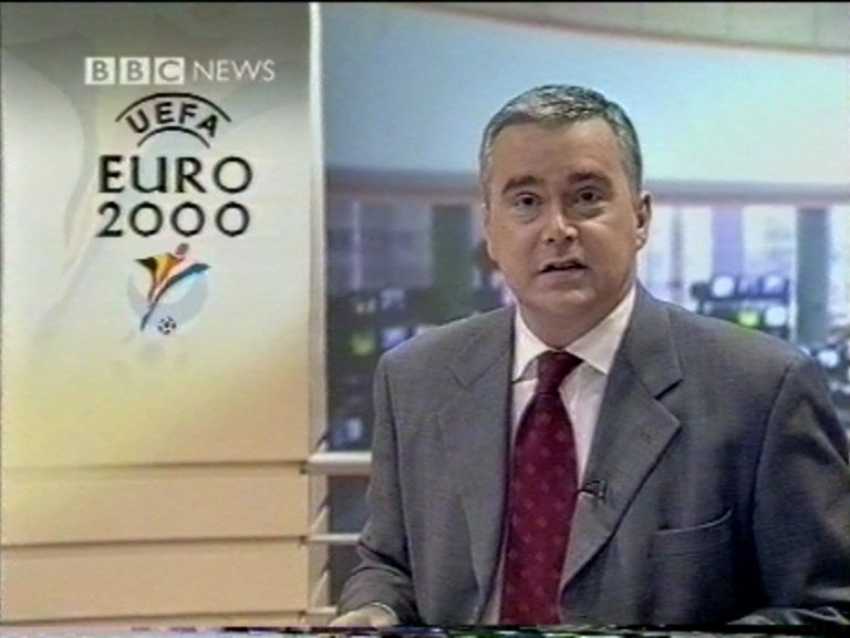

    I tried Neat Video on a sample from a tape and it's doing a job, even if the tape without filters is clear. My question is, is generally Neat Video a good a plug-in or in fact it reduces quality?
  23. Noise has many forms. All VHS recordings have a lot of noise -- like in the image you posted. All noise reducers end up removing at least some small details as well as noise. You have to decide for yourself how much noise reduction to use, if any. Neat video is one of the very best noise reducers. But it needs to sample the noise from your video before using it. Follow the instructions provided. Then adjust the strength to your liking.
