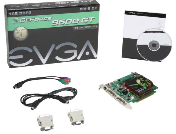

    For NVidia cards look for the circular 9 pin DIN connector which carries analog component and S-Video outputs. Also confirm the card supports "PureVideo HD" (h.264/VC-1/MPeg2 hardware decode). Also check for included 9 pin DIN to Green, Red, Blue RCA component cable. Audio will come from the sound card or mother board.
    Example

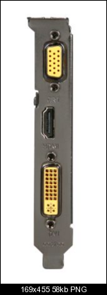

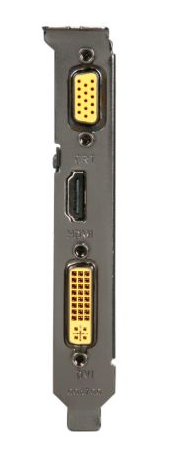

    Beware of the new line of budget "HDMI" cards that lack any analog outputs (other than VGA). There are GT and GTX cards with the DIN connector if you search.
